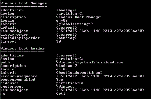

Do you use the Ubuntu boot loader or Win 7? You might open another Admin Command Prompt and type bcdedit to check the Windows boot loader. It should look something like the attachment. If you think you might be having a problem there, you can download EasyBCD version 2 or higher, and have it set up your dual boot.
If you still cannot find it, I would try to get Win 7 working normally which might mean doing a startup recovery on it and loosing temporarily the Ubuntu boot option. I can't really think of anything else to try right now.

I restored the original boot record, but no luck. Needed longer to come out of sleep, but same issue in general. Too long to wake up.
