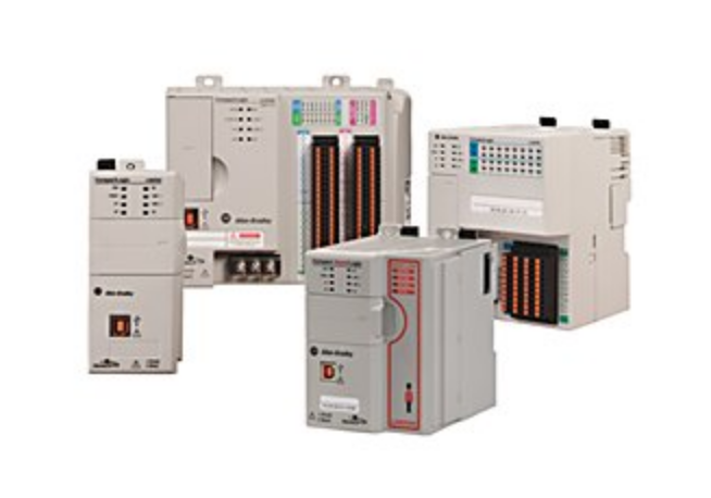

Rockwell’s CompactLogix 5370 family is not obscure kit. The L1, L2, and L3 lines have been widely deployed as small and midrange controllers in the Allen-Bradley ecosystem, the sort of hardware that becomes invisible precisely because it works, ages in place, and accrues business logic that nobody wants to rewrite. That installed-base reality is why a CVSS 7.5 advisory matters even without public exploitation.

The advisory names CompactLogix 5370 L1, L2, and L3 controllers rather than a broad abstract software component. That specificity helps asset owners narrow the blast radius, but it also creates practical work. Many plants do not have a clean, queryable inventory of controller families and firmware versions. They have spreadsheets, electrical drawings, engineering laptops, OEM manuals, tribal knowledge, and asset labels that may or may not match what is actually running.

The affected product family matters. CompactLogix 5370 controllers occupy a practical middle ground in Rockwell’s portfolio: more capable than micro controllers, smaller and cheaper than large ControlLogix systems, and deeply integrated into the Studio 5000/Logix ecosystem. That makes them attractive for OEM equipment, plant expansions, standalone machines, and distributed control tasks.It also makes them sticky. Once a controller is installed, commissioned, validated, and tied into HMI screens, recipes, alarms, historian tags, and maintenance procedures, replacement becomes a business project rather than a purchasing decision. A controller can be technically superseded long before it is economically replaceable. That gap is where advisories accumulate.
