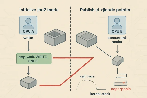

ext4_inode_attach_jinode() assigned ei->jinode too early, before jbd2_journal_init_jbd_inode() had finished initializing the journal inode wrapper. That meant a racing reader could see a non-NULL pointer and assume the object was valid, even though i_vfs_inode inside it had not yet been set. In kernel code, “non-NULL” is not the same thing as “ready”, and this CVE is a reminder that those two ideas must be kept separate with great care.The crash path matters because it lands in the fast commit flush code, not some obscure debug path. The flush logic can call into
jbd2_wait_inode_data(), which eventually looks at the VFS inode mapping and walks memory that should only be touched once the object is fully initialized. The reported oops in the CVE entry is consistent with exactly that sort of race: a reader reached xas_find_marked() through the filemap wait path after being handed a jinode too early. That is not just ugly; it is an availability problem that can take down a workload in the middle of normal filesystem activity.There is also a broader lesson here about journaling filesystems in 2026. The biggest bugs are often no longer the old-school buffer overruns. They are sequencing defects caused by concurrency, publication, and memory ordering. The ext4 patch described in the advisory uses
smp_wmb() and WRITE_ONCE() to publish ei->jinode only after initialization, while readers use READ_ONCE() to fetch it. That is the kernel’s way of saying: the object can exist, but nobody gets to trust it until the writer says it is fully formed.Background

At the heart of CVE-2026-31450 is a simple but dangerous race window.ext4_inode_attach_jinode() used to assign ei->jinode before the journal inode had been fully initialized by jbd2_journal_init_jbd_inode(). A concurrent reader could therefore observe a pointer that looked legitimate even though the object behind it was still mid-construction. In kernel space, that kind of publish-before-ready bug is often enough to trigger a crash.What makes the bug tricky is that the object is not obviously malformed. The pointer is there, and the structure exists. The problem is that one of the embedded relationships the structure depends on has not been safely established yet. That is a much subtler failure mode than a null dereference, and in some ways it is more dangerous because it can survive static inspection and only appear under real concurrency.
Why i_vfs_inode matters
The published description specifically calls out that a reader could see a non-NULL jinode while i_vfs_inode was still unset. That is the key technical detail. Once the fast commit flush path passes that jinode to jbd2_wait_inode_data(), the downstream code expects to be able to access the VFS inode and its mapping. Instead, it can end up dereferencing a pointer that has not been safely established, which is how the crash reaches xas_find_marked() and the filemap code.This is a good example of why kernel developers care so much about object lifetime and initialization order. The object may be allocated, but allocation is not initialization. The object may be named in a structure, but naming it is not publication. The object may pass a sanity check, but sanity checks do not replace memory ordering. Those distinctions sound academic until they become a production outage.
The fast commit flush path
The fast commit flush path is the place where this bug turns from a theoretical race into a practical fault. It is already in the business of waiting on inode data and metadata state, so it naturally assumes the pointers it sees are sound. When that assumption fails, the code can crash while trying to synchronize data that the filesystem believes is safe to flush. That is particularly unpleasant because the failure occurs during a correctness-preserving operation, not during some exotic edge-case API call.In other words, the system is trying to be careful, and the bug punishes that caution. That makes it more than a narrow programmer error. It becomes an operational reliability risk, because the code path can be exercised by routine file sync behavior in workloads that rely on ext4’s journaling guarantees.
The crash signature
The reported oops is important because it demonstrates that the issue was not hypothetical. The call trace runs throughfilemap_get_folios_tag(), __filemap_fdatawait_range(), and filemap_fdatawait_range_keep_errors() before landing in ext4_fc_commit() and then ext4_sync_file(). That stack is exactly what you would expect if a flush or fsync path hit a poisoned inode state while trying to wait on outstanding data.A crash in this region is especially disruptive because it sits on the boundary between application I/O and filesystem metadata handling. Applications may see a failed sync, a hung flush, or a sudden kernel panic depending on the surrounding conditions and platform policy. That is not just a bug in one function; it is a fault in the trust chain between the filesystem and the rest of the kernel.
The Fix Strategy
Initialize first, publish later
The fix is elegant in the way good kernel fixes often are. Instead of exposingei->jinode before its embedded journal state is ready, ext4 now initializes the jbd2_inode first and only then publishes the pointer. That reorders the steps so that any concurrent reader sees either no pointer at all or a fully initialized one. There is no middle state in which another CPU can get a half-baked object and mistakenly treat it as valid.That is the core of the patch’s correctness story. It does not add a global lock, does not slow the subsystem down with heavy serialization, and does not change the data model. It simply ensures the publication point matches the object’s true readiness. In a codebase as performance-sensitive as the kernel, that is the right kind of repair.
Memory ordering matters
The description says the fix uses smp_wmb() and WRITE_ONCE() to publishei->jinode after initialization, while readers use READ_ONCE() to fetch it. That combination is important because this is not just a logic-order issue; it is a cross-CPU visibility issue. The writer needs to ensure earlier initialization stores become visible before the pointer publication becomes visible, and the reader needs to avoid compiler or CPU-level assumptions that could reorder the access.For non-kernel readers, the practical meaning is simple: the kernel is teaching itself not to lie about readiness. Once the pointer is visible, the object must already be safe to use. The fence and one-time access macros are the machinery that make that guarantee believable on real hardware, not just in source code.
Why not a heavier lock?
It is tempting to ask why the kernel did not just wrap the whole operation in a larger lock and be done with it. The answer is that heavy locking would probably solve this bug, but at a cost. ext4’s hot paths are carefully tuned, and adding broad serialization around inode attachment would risk dragging down performance for a problem that can be solved with correct ordering instead. That is why the kernel often prefers precise publication discipline over blunt synchronization.This is especially true in filesystem code, where many operations already contend on shared data structures. A fix that preserves the existing concurrency model while tightening visibility is almost always preferable to a patch that globally narrows throughput. The CVE’s patch text suggests exactly that philosophy.
Numbered summary of the repair
- Initialize the
jbd2_inodefully. - Ensure the VFS inode relationship is established.
- Publish
ei->jinodeonly after initialization completes. - Use memory-ordering primitives to preserve that sequencing across CPUs.
- Let readers fetch the pointer with
READ_ONCE()so they either see nothing or a valid object.
