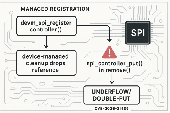

The public CVE text makes the mechanics plain. meson_spicc_probe registers the SPI controller using devm_spi_register_controller, and the teardown path in meson_spicc_remove still performs an explicit spi_controller_put. In managed-resource terms, that is double accounting. The cleanup system will already release the controller when the device goes away, so a second put can underflow the reference count, or at minimum put the object into an invalid lifecycle state. That is why the fix is described so narrowly: remove the extra manual put and let the devm framework do its also worth noting. The CVE record was published on April 22, 2026, and the NVD entry notes references to multiple stable kernel commits, suggesting the issue was already propagated through the Linux security workflow rather than being an isolated upstream curiosity. The Linux kernel documentation explains that CVEs are routinely assigned to fixes that have already landed in stable trees, which is why many kernel CVEs read like disciplined bug-fix records rather than standalone vulnerability narratives.
In practical terms, the risk profile here is more about reliability, crash potential, and teardown correctness than about remote compromise. That does not make the issue unimportant. Kernel bugs that affect object lifetime can still trigger panics, memory corruption in edge cases, or unpredictable behavior on embedded devices and production appliances. In other words, this is exactly the sort of bug operators hate because it hides in shutdown logic, but can still destabiworst possible moment.
Diagram of managed SPI registration and cleanup leading to underflow/double-put vulnerability (CVE-2026-31489).Background​

Why double-put bugs are dangerous​
Reference-count bugs in the kernel are tricky because they do not always fail immediately. A double-put may look harmless in a small test, especially if the object survives long enough that no obvious crash appears. But teardown races are exactly where latent bugs become visible. If a controller’s final put happens twice, the resulting state can depend on timing, prioether other paths still hold references. That is why a bug like this is treated seriously even when the public description is concise.
The real issue is not just “too many puts.” It is the broader violation of the lifetime model. Once a managed helper has taken responsibility for teardown, the manual path must step aside. Leaving both paths active invites underflow, use-after-free conditions in other contexts, or at minimum undefined teardown behavior. In kernel code, that is the sort of defect that can remain dormant until a very specific combination of remove and cleanup events occurs.

A managed helper like devm_spi_register_controller says, in effect, “the device framework will own cleanup for this object.” That changes the driver’s obligations. The remove path can still perform hardware-specific shutdown, but it should not redundantly free objects the framework already owns. The same principle applies across the devm family: once the framework has attached a resource to a device, manual finalization becomes a liability unless explicitly required by the API.
That distinction is subtle enough that it often survives code review. A driver author may see a lingering `spi_controe it is still necessary from the earlier manual-registration era. But once the registration call changes, the cleanup call must change too. CVE-2026-31489 is a good example of why resource ownership audits matter whenever kernel code is modernized.
