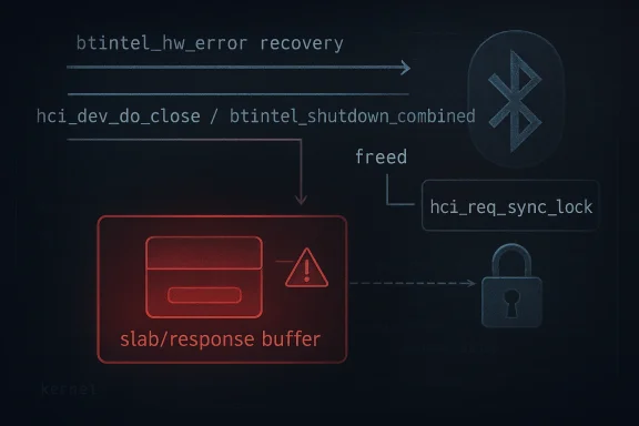

btintel_hw_error() can race with device shutdown logic and end up touching a response buffer after it has already been freed. The fix is straightforward in concept but important in practice: serialize the recovery path with hci_req_sync_lock() so that synchronous HCI command issuers cannot collide. The vulnerability was published on April 22, 2026, and the upstream record describes both a data race and a KASAN-detected slab use-after-free in the affected recovery sequence
Background
Bluetooth support in the Linux kernel is built on top of a fairly intricate command-and-response framework. Intel’s Bluetooth transport code is especially sensitive because it has to coordinate controller resets, firmware recovery, shutdown, and exception reporting while the hardware may already be in an unstable state. That means the code is not just moving packets; it is orchestrating state transitions under pressure, where ordering matters as much as correctness.The vulnerable path is in
btintel_hw_error(), which issues two synchronous HCI commands: a reset and an Intel exception-information retrieval step. According to the CVE record, those calls were made without holding hci_req_sync_lock(), even though the shutdown path hci_dev_do_close() -> btintel_shutdown_combined() also performs synchronous HCI work under that same lock. In kernel terms, that creates a dangerous overlap in ownership and lifetime management for hdev->req_status and hdev->req_rspThe result is not merely a theoretical race. The published trace shows a data-race warning in
__hci_cmd_sync_sk and then a KASAN report for a slab-use-after-free in sk_skb_reason_drop() while the hardware-error worker is still running. That combination is a strong signal that the bug is rooted in a response skb being freed on one path while another path still believes it is valid. In kernel debugging, that is the kind of evidence that usually moves a bug from “maybe unstable” to “definitely memory unsafe”The broader context also matters. Bluetooth drivers often sit at the edge of user experience and low-level hardware control, which makes their failure modes frustratingly ambiguous. A Bluetooth error path may look like a routine recovery helper, but if it shares state with device teardown, it can become a crash trigger during what appears to be normal disconnect or shutdown activity. That is why this CVE belongs in the same class of “small lock, big consequence” kernel issues that can remain hidden until timing aligns just badly enough.
What the Bug Actually Is
At a technical level, CVE-2026-31500 is a synchronization defect, not a parsing bug or a bounds check failure. The core problem is thatbtintel_hw_error() runs a recovery sequence involving synchronous HCI commands without first acquiring the lock that serializes those commands across the rest of the Bluetooth stack. That leaves it exposed to a race with close/shutdown code that uses the same machinery and assumes exclusive access to the request response state.The vulnerability description makes the failure mode clear. While
btintel_hw_error() is still in progress, btintel_shutdown_combined() may free the response skb first. Once that happens, the ongoing hardware-error path can hit a slab use-after-free in kfree_skb(). In other words, the bug is not that the driver frees the same object twice deliberately; it is that the object’s lifetime is no longer protected by the locking discipline that the surrounding code expectsWhy hci_req_sync_lock() matters
The kernel’s synchronous HCI command helpers are not standalone utility calls. They depend on shared request bookkeeping, and that bookkeeping must not be manipulated concurrently. By wrapping the whole recovery sequence in hci_req_sync_lock() and hci_req_sync_unlock(), the fix restores a single-file queueing model for the command path, preventing the error handler from racing with shutdown logic.This is exactly the kind of fix that kernel maintainers prefer for concurrency bugs: tighten the critical section, do not redesign the subsystem. It is smaller, easier to audit, and less likely to break unrelated Bluetooth behavior. It also aligns the hardware-error path with the rest of the synchronous HCI command issuers, which is the real consistency gap at the heart of the issue.
Key technical points:
- The bug is a race condition in a shared command path.
- The affected objects are
hdev->req_statusandhdev->req_rsp. - The visible crash is a slab-use-after-free rather than a simple null dereference.
- The shutdown and error-recovery paths both rely on the same HCI synchronization primitives.
- The fix is to serialize the entire recovery sequence with the existing lock.
