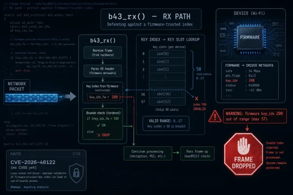

A Small Wi-Fi Driver Bug Exposes a Familiar Kernel Bargain
The b43 driver sits in one of the less glamorous corners of the Linux kernel: support for older Broadcom 43xx wireless hardware through the mac80211 stack. That already tells us why this vulnerability will not generate the same heat as a headline-grabbing local privilege escalation in a core subsystem. It is tied to a specific driver, a specific receive path, and a class of devices many modern laptops no longer ship with.Yet the bug is security-relevant precisely because it happens inside the kernel’s trusted boundary. The vulnerable path,
b43_rx(), receives metadata from firmware, including a key index used to look up entries in the driver’s dev->key[] array. That array has 58 entries. The firmware-controlled index, according to the CVE description, could exceed that size.The old code had a warning check,
B43_WARN_ON, but the important phrase in the CVE is “non-enforcing in production builds.” In other words, the driver could notice something suspicious in development or debugging contexts without reliably stopping the unsafe access on real systems. The fix turns the warning into a hard guard: if firmware reports an invalid key index, the frame is dropped.That change is both mundane and revealing. A bounds check that merely complains is not a security boundary. A bounds check that prevents the operation is.
The Word “Firmware” Is Doing a Lot of Work Here
The kernel.org wording describes the key index as firmware-controlled, and that is the hinge of the issue. Wi-Fi firmware is not just passive configuration data. It is active code running on the device side, feeding information back into the host driver and shaping how the operating system sees packets, encryption state, and device behavior.Modern systems are full of this arrangement. Network cards, GPUs, storage controllers, Bluetooth chips, touch controllers, and even keyboards increasingly depend on opaque or semi-opaque firmware components. The OS kernel often has to treat those components as partners while still defending itself from their mistakes.
That bargain is uncomfortable. Firmware may be buggy. It may be malformed. It may be old. It may be proprietary and underdocumented. In some threat models, it may even be attacker-influenced, especially when the device is parsing hostile radio traffic, USB input, or network frames before the host driver has a chance to enforce policy.
CVE-2026-46122 is not, based on the public description, proof of remote code execution or an actively exploited Wi-Fi attack. It is an out-of-bounds read caused by trusting a firmware-provided index. But that is exactly the type of primitive kernel developers have spent the last decade trying to squeeze out of production code. It may only leak adjacent memory or destabilize the driver. It may be hard to trigger reliably. It may require hardware few people still use. The point is that none of those qualifiers make the missing enforcement defensible.
The Patch Is Tiny Because the Trust Model Was Wrong
The fix described by the CVE is simple: drop the frame when the key index is invalid. That is the right shape for this bug. The driver does not need to guess what the firmware meant. It does not need to repair the index, clamp it, or soldier on with a best-effort fallback. If the metadata points outside the array, the packet is not trustworthy enough to process.This is one of those cases where the code change is likely smaller than the institutional lesson. Kernel drivers often accumulate checks that were originally written as developer diagnostics. A warning says, “This should never happen.” A security boundary says, “If this happens, we stop.”

The Patch Says More About Defensive Coding Than About Broadcom
It is tempting to make the story about Broadcom, because b43 is a Broadcom driver and Broadcom wireless support has long been a recurring Linux pain point. But the specific failure mode is not unique to one vendor. Any driver that accepts an index, length, count, descriptor, queue ID, or key slot from device-side code faces the same class of risk.The kernel side must treat those values as untrusted until proven otherwise. That is easy to say and harder to enforce across millions of lines of driver code written over decades. Some paths were designed when the security implications of device metadata were less aggressively scrutinized. Others were written under the assumption that firmware and driver are two halves of a cooperative system.
Modern threat modeling has moved on. Firmware is part of the attack surface. Device state is part of the attack surface. Radio-facing code is part of the attack surface. Even if the hardware is old and the exploitability is unclear, the correct design principle is no longer debatable.
In that sense, CVE-2026-46122 is a small win for kernel hardening. It replaces a diagnostic assumption with an enforced condition. The code now says: if the key index is outside the table, the frame is not processed. That is the right answer.
