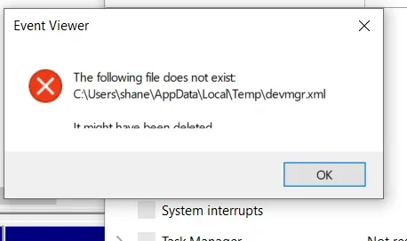

  • Was Running Windows 10 Home 64-Bit and is Know Running Windows 10 Pro 64-Bit also do not know if this is what is causing this or not but I don't Think it would have Really Mattered since it is Just a Different OS Than the Home Edition of Windows Plus Event Viewer at Times Does Not Respond and has a Devmgr Deleted Error

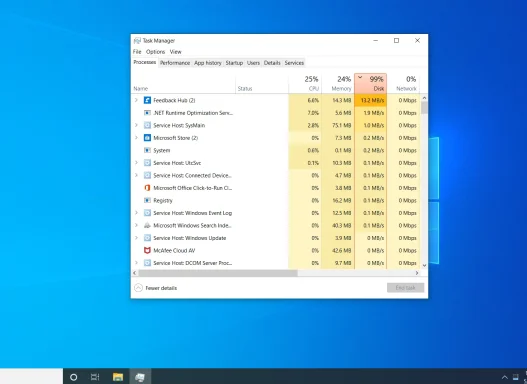

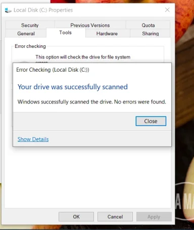

causing a lot of Not Responding errors and being slow to the point of almost being Unusable HDD Usage in Task Manager Can Go as High as 100% @ Times and Basic Tasks Like Running Microsoft Edge and also Just Booting the PC up Black Background every Know and then can see mouse but a long black background for a while before the actual OS Loads have been wandering if I shouldn't just go ahead and replace it w/ a Samsung 860 EVO SSD Since this is a Laptop I Have also ran SEA Tools from Seagate. The Fix All Long Test Came out w/ Bad Sectors @ Around 50% Completed was Recommended to run Seagate Bootable Ran Seagate Bootable Test Came Out w/ Pass Rating but then Reran the Test on SEA Tools from Sea Gate Fix All Long Test Came Out as Fail @ although it was around 85% Every Other Test has passed except for the Advanced Test for I have Not Run it Although I Do have a Full Backup of My Data along w/ a System Repair Disc So that if I Do have to Replace the HDD w/ an SSD I will not Lose any of my Data also Ran a CHKDSK from CMD Command Line Via Administrator Came Up w/ This

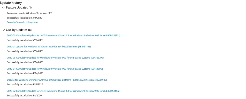

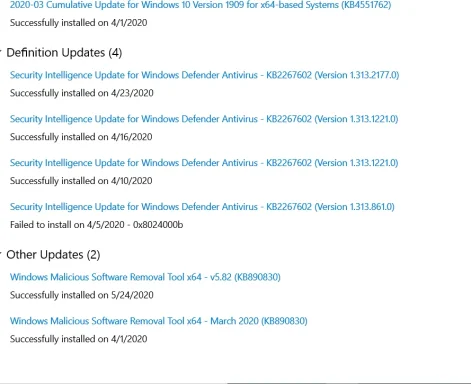

I am Know Going to Attach Some Images of Certain things I'm Running Into Really Just want Someone Else's Opinion Though Before I do go and buy a SSD
