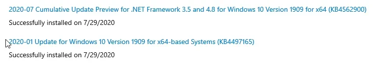

Hi,
When I woke up this morning I turned on my computer and it had an error message, unfortunately I didn't look at this error message and continued to start up (computer updated, see attached for list of updates). When I loaded up I noticed many different programs weren't accessible anymore. Upon further inspection I learned that my E: Drive was missing. I tried researching this as much as possible but I am not too techy and wasn't able to find an answer. What I can say is that I have checked the Disk Management section as well as several others and the drive is not appearing even after rescanning for disks. I opened up my computer and checked the connections and they seemed to be good, but again I don't really know enough.

I assume that the error message was automatically installed update has turned off your usb ports

I would next boot into the firmware(BIOS/UEFI) menu and see if it's detected there. If not then I'd say the drive has failed.
Will do, and if it isn't detected there what do I do? I just find the timing odd being that I just installed a windows update.
Windows updates have no bearing on the firmware. If it's not detected the drive will need to be replaced.
