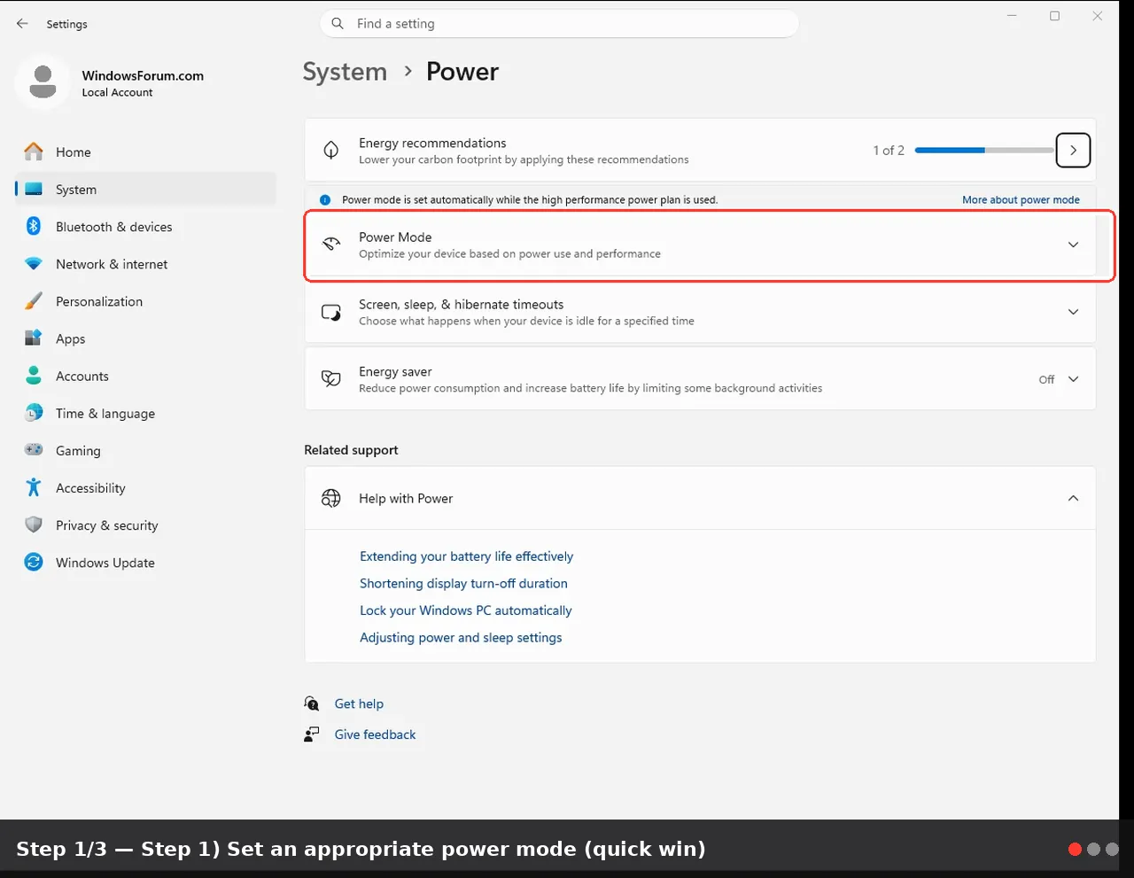

Step 1) Set an appropriate power mode (quick win)​
Windows 11 Power settings page with the Power mode drop-down visible.
Power Throttling behavior depends heavily on your power mode. If you’re in a very battery-saver-friendly mode, Windows will be more aggressive about throttling background tasks.
  • Click the battery/network icon in the taskbar.
  • Adjust Power mode:
  • Windows 11: Choose Best performance (or Balanced if you want a compromise).
  • Windows 10: Move the slider toward Better performance or Best performance.
  • If you’re testing, keep the system consistent:
  • Plug in AC power for repeatable results, or stay on battery for “real world” behavior—just don’t mix both during comparison.
Tip: If your goal is “foreground feels snappier,” start with Balanced + Power Throttling tuning. “Best performance” can reduce the need for throttling by simply giving everything more CPU.
