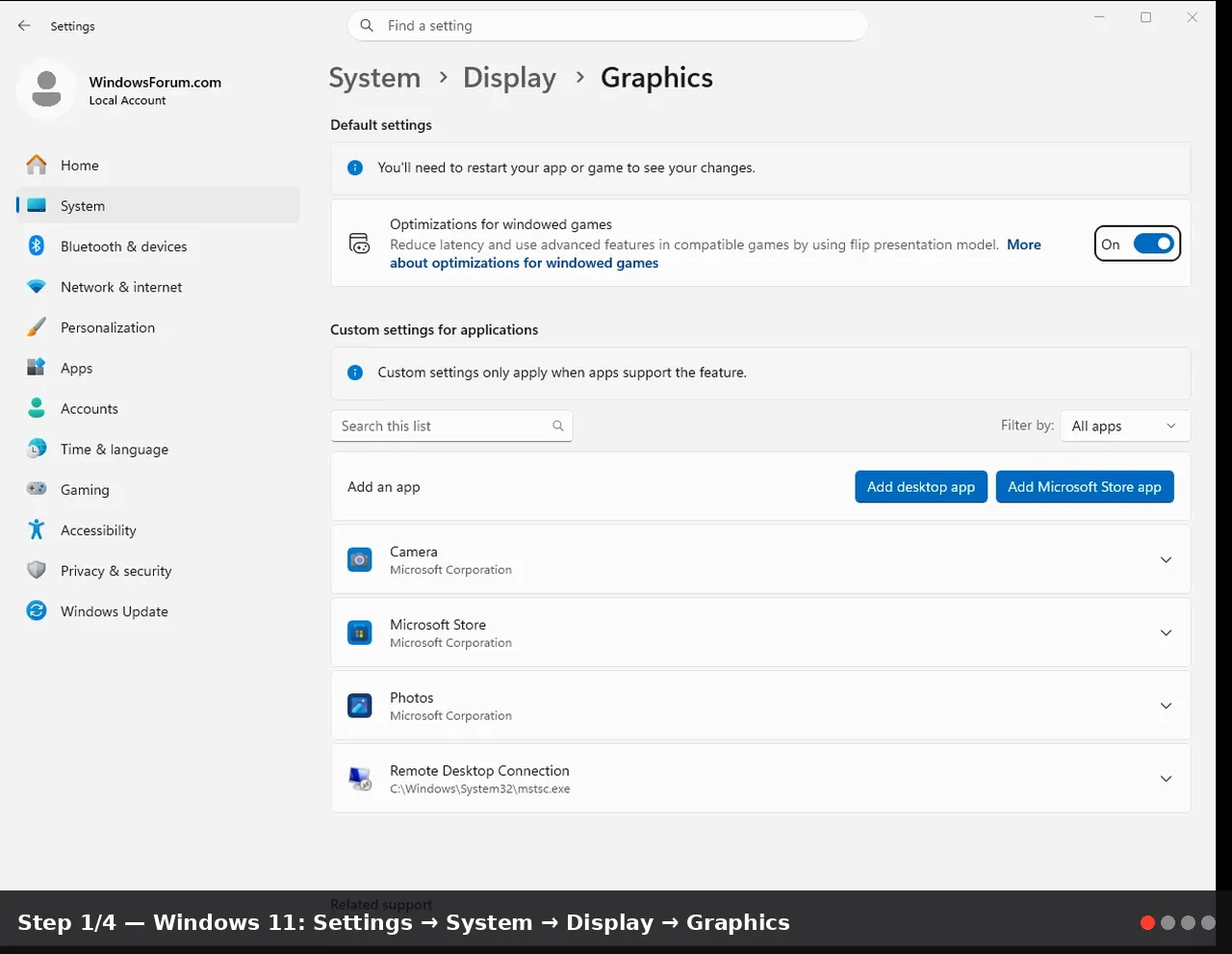

Step-by-step: Enable VRR in Windows (and verify it’s active)​
VRR helps reduce stutter and tearing by letting the monitor refresh dynamically with your game’s FPS.
1) Check Windows VRR setting​
  1. Open Settings
    • Windows 11: Settings → System → Display → Graphics
    • Windows 10: Settings → System → Display → Graphics settings
  2. Look for Variable refresh rate (wording may vary slightly).
  3. Toggle Variable refresh rate to On.
Note: If you don’t see the VRR toggle, Windows may not detect VRR support. Confirm your monitor supports it, the correct cable is used (common issue), and VRR is enabled in the monitor’s on-screen menu.
