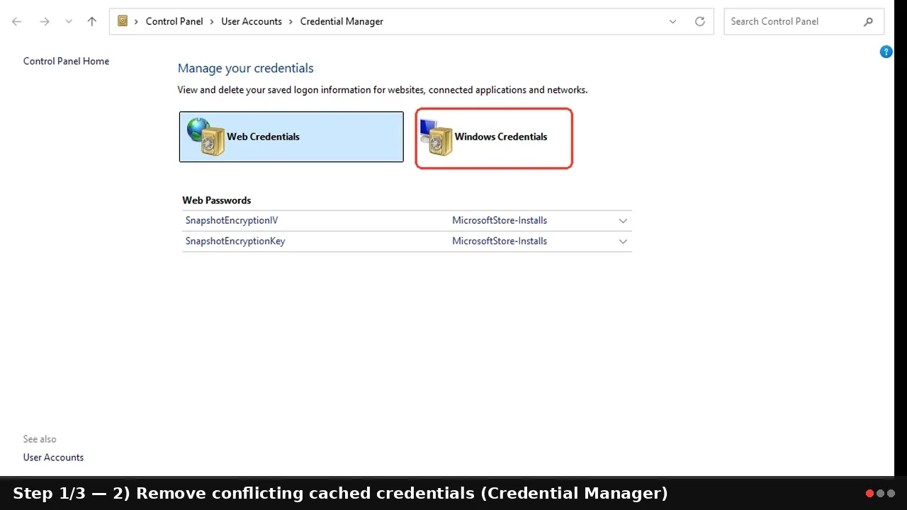

2) Remove conflicting cached credentials (Credential Manager)​
  1. Press Win + S, type Credential Manager, and open it.
  2. Click Windows Credentials.
  3. Look for entries related to your server/share, such as:
    • \\NAS
    • \\NAS.local
    • \\192.168.1.50
    • Any entry that matches the host you’re mapping
  4. Expand the matching entry and click Remove.
Tip: If the server can be reached by name and IP, you may have two credential entries. Remove both if you’re unsure and re-add cleanly.
