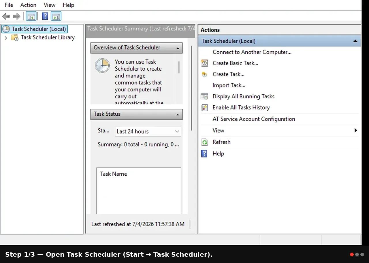

    GUI method (recommended):
  • Open Task Scheduler (Start → Task Scheduler).
  • Click “Create Task…” (not “Create Basic Task”).

Task Scheduler management console with the task tree and actions pane visible.
