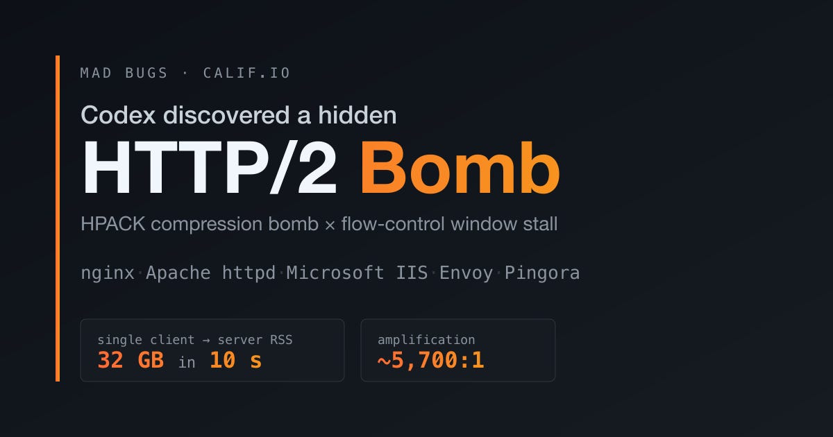

On June 3, 2026, researchers at Calif disclosed “HTTP/2 Bomb,” a denial-of-service technique reportedly found with OpenAI Codex that can exhaust memory on default HTTP/2 deployments of nginx, Apache httpd, Microsoft IIS, Envoy, and Cloudflare Pingora. The uncomfortable lesson is not that AI suddenly invented a new class of vulnerability. It is that modern web infrastructure has become complicated enough that old weaknesses can be recombined into failures the ecosystem did not collectively model. For WindowsForum readers, the IIS angle matters, but the broader story is about every administrator who assumed HTTP/2 was a solved operational risk because it has been in production for years.

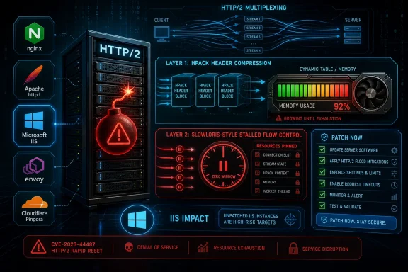

The compression piece of HTTP/2 Bomb targets HPACK, the header compression system used by HTTP/2. HPACK maintains a dynamic table so repeated headers do not need to be sent again in full. A client can send a compact reference to something already in the table, and the server expands it back into the full header representation.
That is normally a win. The same cookie, authorization metadata, user-agent fields, and other repetitive header material can be represented compactly on the wire. At internet scale, shaving repeated bytes is meaningful.
The problem is that compression is always a bargain with asymmetry. A small encoded input can trigger a larger decoded output. In a benign system, that asymmetry saves bandwidth. In an adversarial system, it can become an amplifier.
HTTP/2 Bomb exploits that asymmetry by placing a header into the dynamic table and repeatedly referencing it using very small indexed representations. The attacker sends little; the server allocates much more. Reports from the researchers describe the server-side allocation cost as ranging from roughly dozens of bytes per wire byte in some implementations to thousands of bytes in others.
That is the “bomb” half of the name. It is not a bandwidth flood in the classic sense. It is a request pattern that convinces the server to convert a modest trickle of traffic into a large and growing memory burden.
HTTP/2 Bomb adapts that idea to HTTP/2 flow control. In the reported attack flow, the client advertises a zero-byte flow-control window. That prevents the server from completing the response in the normal way. The request remains unresolved, and the memory allocated during header expansion is not promptly released.
This is the crucial chain. Compression amplification creates the memory pressure. Flow-control stalling keeps that memory pinned. One primitive makes the server allocate; the other prevents normal cleanup.
That is why the attack is more severe than either ingredient alone. A compression bomb that is quickly processed and freed may be painful but bounded. A resource hold without strong amplification may require many clients or a long dwell time. Together, the attacker gets a low-bandwidth way to accumulate server memory at frightening speed.

The reported test results are stark. Envoy 1.37.2 was said to exhaust 32GB of RAM in about 10 seconds. Apache httpd 2.4.67 reportedly hit 32GB in about 18 seconds. nginx 1.29.7 reportedly reached the same mark in about 45 seconds. IIS on Windows Server 2025 reportedly exhausted 64GB in about 45 seconds.
These numbers should be treated as lab results rather than guarantees about every production network. Real deployments may have front-end protection, connection limits, tuned buffers, cloud load balancers, or upstream mitigations that change the outcome. But even as directional evidence, they are enough to move this from “interesting” to “patch window now.”

In the meantime, the defensive posture is not mysterious. If HTTP/2 is unnecessary on a given IIS deployment, disabling it reduces exposure. If HTTP/2 is required, placing a proxy, load balancer, or firewall in front of IIS that enforces strict limits on headers, streams, connection behavior, and flow-control abuse becomes more important.
The hard part is inventory. Many Windows shops know which servers run IIS, but not always which ones negotiate HTTP/2, which are exposed externally, which sit behind protective intermediaries, and which internal apps quietly gained HTTP/2 through OS or framework defaults. That uncertainty is where emergency change windows become messy.
Administrators should also be wary of assuming that an upstream proxy automatically solves the problem. A proxy can protect an origin if it terminates HTTP/2 and enforces sane limits before forwarding. But if the proxy itself is vulnerable, or if it tunnels problematic behavior downstream, the protective layer may simply become the first component to fall over.
The safest immediate work is therefore boring and concrete: identify internet-facing HTTP/2 endpoints, determine the terminating component, check version and patch status, review memory and connection limits, and test whether disabling HTTP/2 has unacceptable user impact. In many enterprise apps, the performance benefit of HTTP/2 is real but not existential. Availability during an active exploit wave is existential.
A reverse proxy that normalizes traffic, caps decompressed header memory, limits concurrent streams, and refuses pathological flow-control behavior can blunt this attack. A reverse proxy that accepts the same malicious pattern and exhausts its own memory merely moves the crash from the origin to the edge. In some environments that is still better, because edge tiers are easier to scale or isolate, but it is not a fix.
