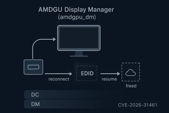

At its core, CVE-2026-31461 is a memory leak in the AMDGPU display manager. The affected logic updates
The public wording in the CVE record is unusually clear: the sink-connected path overwrote the connector’s EDID pointer without freeing the old allocation, and the fix simply frees the previous object before updating the pointer. That narrowness is btructive. It means the bug is likely limited in scope, but it also highlights how much of kernel correctness depends on exact ownership discipline.

At its core, CVE-2026-31461 is a memory leak in the AMDGPU display manager. The affected logic updates aconnector->drm_edid when a sink is connected, but the previous drm_edid allocation was not freed first. Over time, repeated resume e lost allocations, which is the classic footprint of a resource lifecycle bug rather than a structural memory safety flaw.Why this matters
A leak sounds harmless until you look at the path it lives in. Resume handling is not an edge case for mobile systems; it is a routine operation. If a driver leaks on every reconnect or resume, the bug can become a persistent slow burn, especially on laptops, docking stations, and multi-monitor systems that regularly cycle through display detection.The public wording in the CVE record is unusually clear: the sink-connected path overwrote the connector’s EDID pointer without freeing the old allocation, and the fix simply frees the previous object before updating the pointer. That narrowness is btructive. It means the bug is likely limited in scope, but it also highlights how much of kernel correctness depends on exact ownership discipline.
A memory leak does not always produce a visible failure right away. Instead, it can show up as degradation: slower resume behavior, increased memory pressure, instability on constrained systems, or symptoms that appear unrelated to the real cause. That makes it harder for administrators to diagnose and easier to dismiss as “just a flaky driver,” which is why even a modest-seeming CVE can be worth tracking.
The resume path angle
The most interesting part of this bug is that it is tied to resume. Suspend/resume paths are often the most fragile code in graphics drivers because they have to restore hardware state while also re-validating display topology. That means the bug is not about one-time initialization; it is about the repeated transition between power states, where stale objects and replacement logic tend to collide.- The fl sink is connected.
- The connector’s EDID pointer is overwritten.
- The previous allocation is not released first.
- Repeated resumes can accumulate leaked memory.
- The fix is to free the old EDID before assignment.
