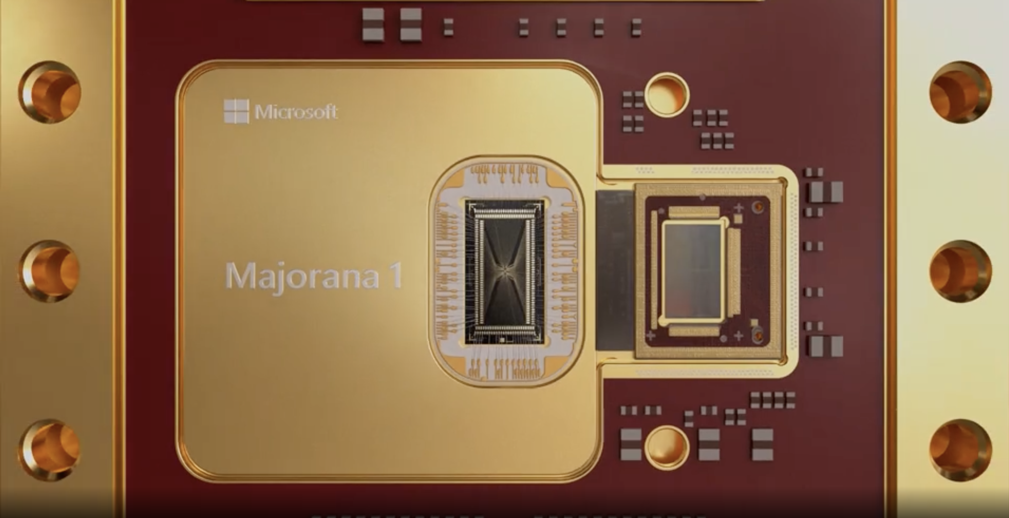

The Majorana 1 device was not a universal quantum computer, nor even a complete working topological qubit in the ordinary engineering sense. It was a test platform built around an indium arsenide nanowire coupled to aluminium, cooled to temperatures near absolute zero, and tuned with electrostatic gates.
Microsoft’s 2025 paper reported interferometric single-shot parity readout in InAs-Al hybrid devices. In plainer terms, the company said it could read the even-or-odd occupation state associated with a pair of Majorana zero modes. That is an essential operation for Microsoft’s architecture, even if it is not the same as performing arbitrary quantum logic.
The company’s measurement linked the two ends of the wire into a loop and used radio-frequency reflectometry to probe quantum capacitance. Microsoft reported a two-state signal that oscillated with the expected magnetic-flux period. In its interpretation, a disordered gapless wire could not sustain that clean signal, so the signal itself supported the conclusion that the device was in the topological regime.
Before reaching that readout point, Microsoft used an automated tuning method called the Topological Gap Protocol. The protocol was meant to identify promising regions where the device appeared properly gapped and to reject the misleading cases that have dogged the field for more than a decade. It is both a practical tuning tool and, inevitably, part of the evidentiary chain.
That dual role is now the heart of the disagreement. Microsoft says the protocol selected operating points but did not carry the paper’s physics conclusion. Legg says the protocol’s behavior, the raw transport data, and Microsoft’s presentation of those data are inseparable from the claim.
