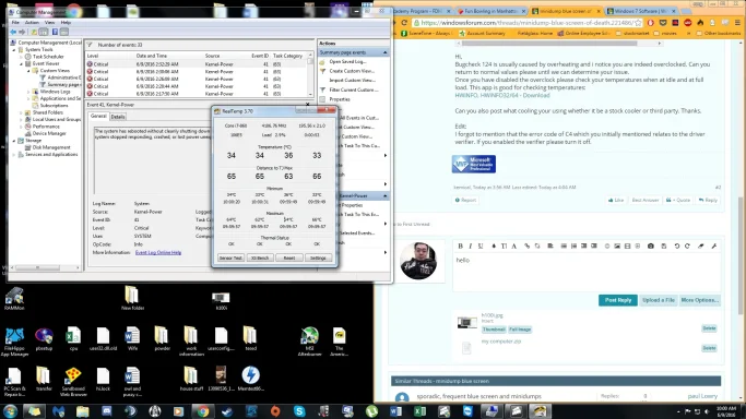

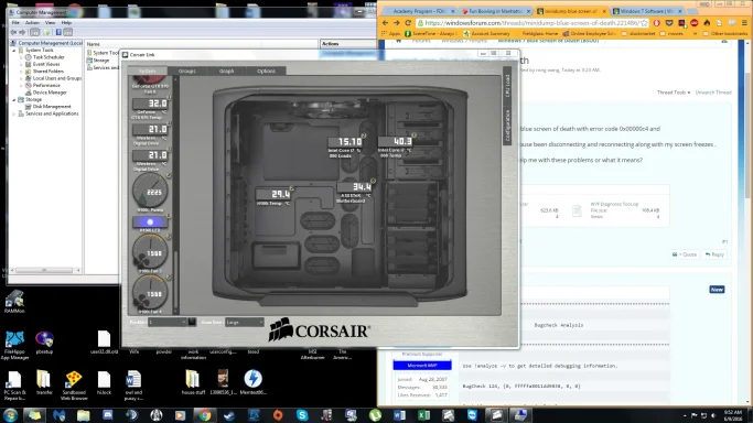

hello,
When under load or gaming (i.e Counterstrike) it would spike up to 65-69 but it would drop back down. I will reapply arcitic paste soon due to the summer and the overclocking.
so do you think the overclocking have to due with my keyboard, mice and monitor to freeze up sometimes?

i was getting crashed but the minidump hasn't created an update file for it . the minidump i attached was from 3/17/2016, i noticed too
