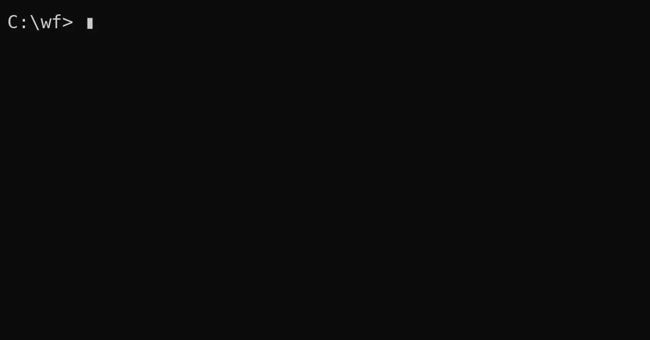

Step 2: Open Command Prompt as Administrator​
  • Open the Start menu.
  • Type:
cmd
  • Right-click Command Prompt.
  • Select Run as administrator.
  • Approve the User Account Control prompt.
Use Command Prompt rather than PowerShell for the simplest mklink syntax. The mklink command is a Command Prompt command.
