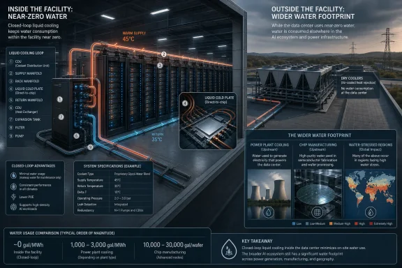

The DSX design matters because AI hardware has reached a point where air cooling is no longer an adequate default. Rubin-generation systems are expected to push rack densities beyond the comfort zone of traditional server rooms, with power levels that make fans increasingly inefficient, noisy, and physically limiting. Liquid cooling is not a green accessory bolted onto the side of the system; it is becoming a condition of deploying the system at all.

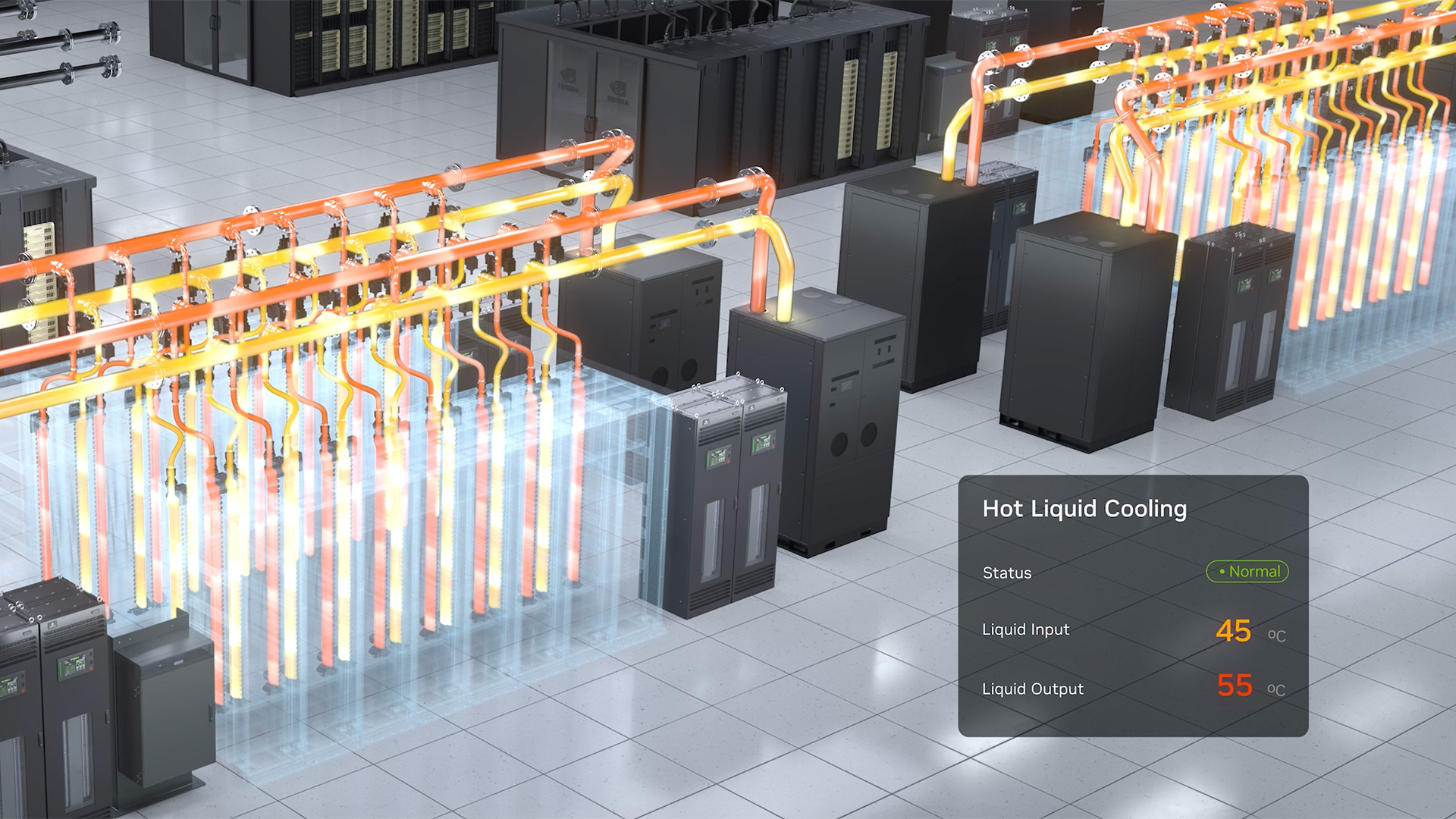

Nvidia’s reference design uses a closed loop of coolant, reportedly a mixture of water and propylene glycol, moved through cold plates that sit close to the heat-producing components. Instead of blasting air across servers and relying on chillers or evaporative towers to manage the resulting heat, the system captures that heat at the chip and carries it out to dry coolers. The loop is filled and recirculated rather than continuously consuming fresh water.
The striking part is the temperature. Nvidia is pushing coolant inlet temperatures up to around 45°C, far warmer than the chilled-water assumptions that shaped much of the data center industry. That higher temperature makes the heat easier to reject outdoors without conventional chilling because the system has a larger useful gap between the coolant and ambient air for much of the year.
This is why the design is not merely “liquid cooling,” a phrase that has been around long enough to become marketing wallpaper. Warm-water cooling at this scale changes the economics of the plant. If the coolant can run hot, the facility can often lean on dry coolers rather than evaporative systems, reducing both water use and the power load tied to chilling equipment.
For WindowsForum readers used to thinking at the PC level, it is the difference between adding a better radiator and redesigning the platform around a new thermal envelope. Nvidia is not just swapping the cooler. It is telling facility designers, rack vendors, cloud operators, and procurement teams to build around a new assumption: the AI rack is now a liquid-cooled machine room component, not a server cabinet with heroic airflow.

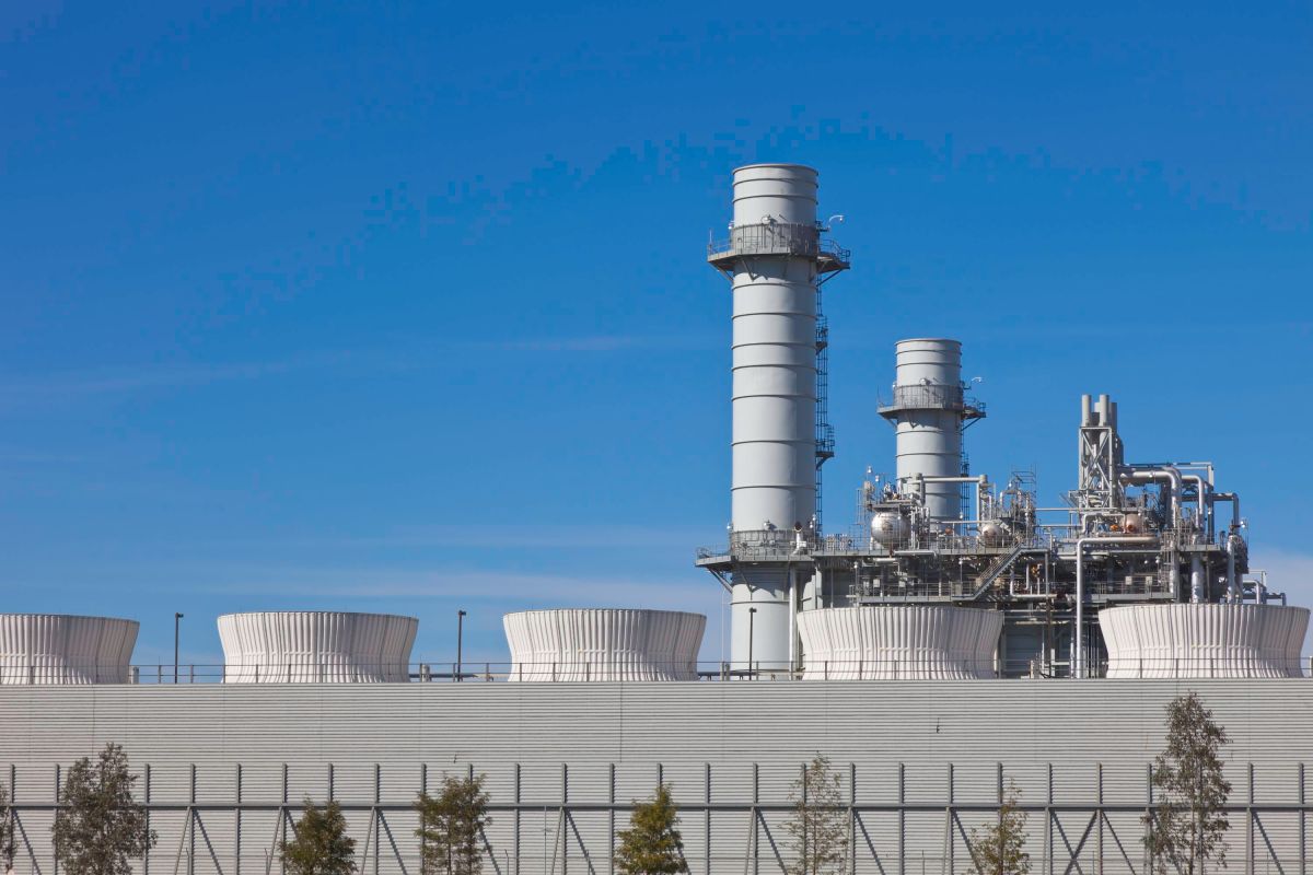

Power generation is the first omitted layer. Thermal power plants, including coal, gas, and nuclear facilities, often withdraw and consume water as part of steam-cycle generation and cooling. The exact water intensity varies enormously by plant type, cooling method, region, and grid mix, but the basic point is not controversial: electricity is not water-free simply because the server hall is.

Warm-water cooling has a simple dependency: the outside world still exists. A dry cooler works best when ambient temperatures are comfortably below the coolant temperature. In Scotland, Scandinavia, the Pacific Northwest, or parts of northern Europe, a 45°C loop gives operators plenty of room for passive heat rejection across most of the year. In Phoenix, Dallas, or Singapore, the equation is less forgiving.
Nvidia has acknowledged that some climates may still require chillers for a small share of operating hours. That caveat is doing a lot of work. The difference between “almost never” and “often enough to matter” is not a philosophical dispute; it is a site-selection issue, an engineering issue, and eventually a permitting issue.
This is where the climate-week announcement collides with the geography of the AI buildout. Much of the United States data center boom is happening in regions where land, power interconnection, tax incentives, and fiber routes line up better than water availability. Those regions are not always the regions where dry cooling performs best.
The result is a paradox that local governments will notice quickly. The same design that makes AI data centers easier to defend in water-stressed places may be least able to deliver its cleanest water claims in the hottest of those places. A closed loop helps everywhere, but the promise of eliminating chillers is climate-dependent.
That does not make the technology unsuitable for hot regions. It means the headline number should travel with a weather map attached. A facility in a temperate climate and a facility in the desert may share the same Nvidia reference architecture while delivering very different real-world water and energy outcomes.

The catch is that AI data centers do not run on coolant. They run on electricity, and electricity often carries a water footprint of its own.
In much of the United States, the grid still includes thermoelectric power generation: natural gas, coal, and nuclear plants that use heat to make steam and water to manage that heat. The water consumed or withdrawn at those plants does not appear on the data center’s water meter, but it is still part of the environmental cost of running the workload.
That distinction is where the public conversation often becomes slippery. A company can truthfully say that a facility uses little or no water on site while the electricity it buys increases water demand somewhere else. The boundary of the claim is not false, but it is incomplete.
This is why researchers separate direct and indirect water use. Direct water is what the facility consumes for cooling and humidification. Indirect water is tied to power generation. A serious accounting of AI’s footprint has to include both, even though only one is under the data center operator’s immediate physical control.
