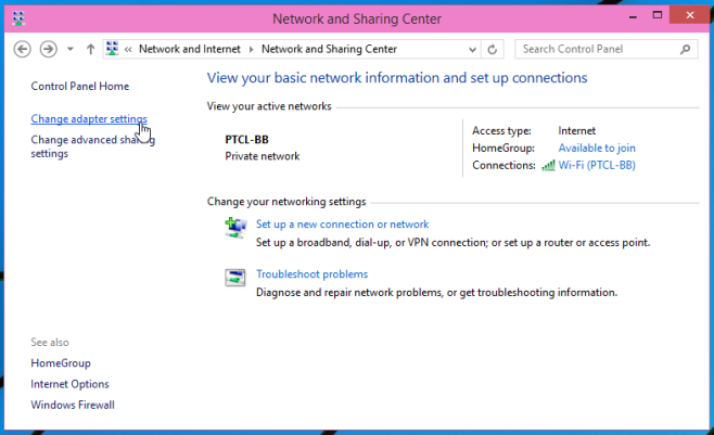

The Old Control Panel Ritual Is Mostly a Museum Exhibit
The classic workflow is familiar to anyone who has spent time in the deeper corners of Windows. Open Control Panel, go to Network and Sharing Center, choose Change adapter settings, press Alt to reveal the old menu bar, open Advanced Settings, and rearrange the order of connections. Ethernet goes to the top, Wi-Fi moves below it, and the user clicks OK with a sense of administrative accomplishment.That ritual made more sense in older Windows versions, particularly in the Windows 7 and early Windows 10 era when Control Panel still felt like the real cockpit and Settings was still growing into the job. The interface exposed binding order because Windows had more visible need to decide how network services and protocols attached themselves to adapters. It was a world where the operating system still wore much of its plumbing on the outside.
But Windows 11, and many current Windows 10 installations, do not make that workflow central. Some systems hide it. Some expose pieces of it. Some users can still find the menu, but changing the order does not necessarily produce the result they expect for internet traffic.

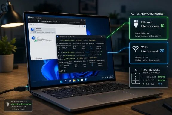

This is why the manual metric method is the right modern answer. Set Ethernet to a lower number, set Wi-Fi to a higher number, and Windows has a direct instruction. Ethernet at 10 and Wi-Fi at 20 is not magic, but it is clear.
The Three-Step Fix Is Really About Taking Auto Out of the Loop
The simplest GUI version still begins in familiar territory. Open the network adapter options, right-click the Ethernet adapter, open Properties, select Internet Protocol Version 4, choose Properties, then Advanced. There, uncheck Automatic metric and enter a low number such as 10.Then repeat the process for Wi-Fi, but assign a higher number such as 20. If the network uses IPv6, repeat the same logic under Internet Protocol Version 6 as well. That last part is easy to overlook, and it is one of the reasons users sometimes swear the setting “didn’t work.”
This is the point where Windows’ layered networking model becomes visible. IPv4 and IPv6 can have separate interface settings, and modern networks increasingly use IPv6 for real traffic rather than treating it as ornamental plumbing. If only IPv4 is adjusted while IPv6 remains automatic, some connections may still behave in ways the user does not expect.
There is also a psychological trap in the numbers. Users often assume “higher priority” means typing a higher value. Windows metrics work the other way around. Lower number, higher preference. Ethernet 10 beats Wi-Fi 20.

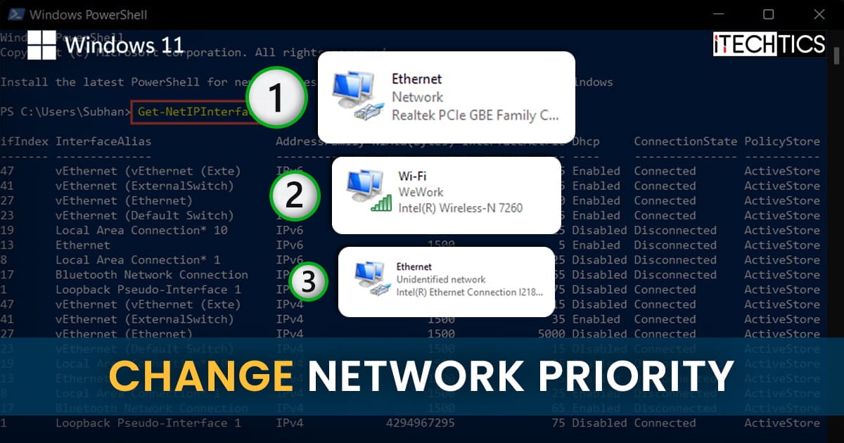

PowerShell Gives the Same Answer Without the Dialog Box Maze
The PowerShell method is cleaner, especially for administrators or anyone configuring more than one machine. RunningGet-NetIPInterface shows the relevant interfaces and their indexes. From there, Set-NetIPInterface can assign a metric directly to Ethernet and Wi-Fi.The concept is the same as the GUI method, but the command line removes ambiguity. It also makes verification easier. After setting the values, running
Get-NetIPInterface again should show whether the intended metrics are active.PowerShell is also the more honest interface for what Windows is doing. The Control Panel path suggests that the user is editing adapter personality. PowerShell makes clear that the user is editing IP interface behavior. That distinction is not cosmetic; it is the difference between rearranging furniture and changing the route map.
For IT pros, PowerShell also scales. A helpdesk note that says “set Ethernet to metric 10 and Wi-Fi to metric 20” can become a script, a remediation step, or a baseline check. In managed environments, that is more useful than asking users to press Alt in an aging Control Panel window and hope the right menu appears.
Verification Is Not Optional When Windows Has Multiple Paths
After changing metrics, users should verify the result rather than assume the dialog box did what it promised.Get-NetIPInterface, route print, and netstat -rn all provide ways to inspect the routing state. The important thing is to confirm that Ethernet has the lower metric for the relevant address family.This is especially important on machines with VPN clients. VPN adapters often insert routes with aggressive metrics because their job is to capture traffic. Corporate endpoint tools may do the same. Virtualization products can also add adapters that make the list look more complicated than “Ethernet versus Wi-Fi.”
