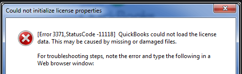

QuickBooks Error 3371 Status Code 11118 is a Windows-side QuickBooks Desktop launch failure in which the application cannot load or validate its license data, most often because the local entitlement file is damaged, missing, blocked, or dependent system components are broken. It is annoying precisely because it appears before the company file opens, making a licensing problem look like a data disaster. The good news is that the accounting file is usually not the thing in trouble. The bad news is that this error exposes how brittle desktop software can feel when activation, Windows components, antivirus tools, and small-business urgency collide.
The first job in diagnosing Error 3371 Status Code 11118 is to separate fear from fact. QuickBooks Desktop users often see the message after a normal shutdown, a Windows update, a machine migration, a hard-drive clone, or an interrupted install. The timing makes it feel random, but the underlying failure is usually very specific: QuickBooks cannot initialize the licensing properties it expects to read at startup.
That distinction matters. A corrupted company file usually produces a different class of symptoms: file-open errors, data verification problems, multi-user access failures, or rebuild prompts. Error 3371 generally arrives earlier in the boot sequence, before QuickBooks has even reached the point where it can do meaningful work with your company file.
Think of the company file as the ledger and the entitlement data as the keycard. If the keycard is unreadable, QuickBooks refuses to enter the building. That does not mean the ledger has been shredded.
The catch is that users do not experience it that way. They experience a locked door at the exact moment payroll, invoicing, tax prep, or month-end reporting needs to happen. For a small office without a dedicated admin, “license data failed” and “my accounting system is down” are functionally the same emergency.
When that file is healthy, nobody thinks about it. QuickBooks opens, validates itself silently, and moves on. When the file is damaged or unreadable, the entire desktop application can fail before the user reaches the familiar home screen.
This is why the common fix looks strangely primitive: close QuickBooks, navigate to the entitlement folder, delete the ECML file, and reopen the application. QuickBooks then rebuilds the entitlement data and asks the user to revalidate or reactivate as needed. For many users, that single reset is enough.

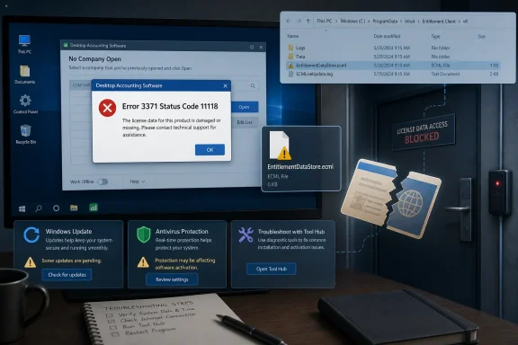

QuickBooks Has Not Lost Your Books — It Has Lost Its Passport
The first job in diagnosing Error 3371 Status Code 11118 is to separate fear from fact. QuickBooks Desktop users often see the message after a normal shutdown, a Windows update, a machine migration, a hard-drive clone, or an interrupted install. The timing makes it feel random, but the underlying failure is usually very specific: QuickBooks cannot initialize the licensing properties it expects to read at startup.That distinction matters. A corrupted company file usually produces a different class of symptoms: file-open errors, data verification problems, multi-user access failures, or rebuild prompts. Error 3371 generally arrives earlier in the boot sequence, before QuickBooks has even reached the point where it can do meaningful work with your company file.
The Tiny ECML File That Can Stop an Accounting Department
At the center of many 3371 cases is a file calledEntitlementDataStore.ecml. It lives under Intuit’s entitlement client data inside Windows’ ProgramData directory, a location hidden from many users by default. The file stores activation and license-related information that QuickBooks reads when it starts.When that file is healthy, nobody thinks about it. QuickBooks opens, validates itself silently, and moves on. When the file is damaged or unreadable, the entire desktop application can fail before the user reaches the familiar home screen.
On current Windows installations, the usual path is:
C:\ProgramData\Intuit\Entitlement Client\v8Some older installations or older QuickBooks Desktop versions may use a different entitlement-client version folder. That is one reason forum advice often differs slightly: the principle is the same, but the exact folder can vary by version and installation history.
This is also where bad troubleshooting advice can make things worse. Users should not go on a deletion spree through
ProgramData, registry keys, or QuickBooks folders because one support article mentioned a license file. The target is narrow. The repair is surgical.The Official Repair Path Starts with the Tool Hub, Not Folk Magic
Intuit’s more modern guidance pushes users toward QuickBooks Tool Hub, particularly its 3371 Error Fix and installation repair tools. That is a better starting point for many nontechnical users because it packages several repairs into a guided interface instead of asking someone under pressure to browse hidden folders.Tool Hub is not magic, but it does reflect the reality of the problem. Error 3371 is not always one bad file. It can also be caused by broken Windows components, damaged QuickBooks program files, or installation debris left behind after an update or failed reinstall.
The Installation Issues section of Tool Hub can run diagnostic repairs for components QuickBooks depends on, including Microsoft .NET Framework, MSXML, and Visual C++ runtime pieces. Those dependencies are invisible until they break. Then a business application looks broken even though the actual failure is deeper in the Windows stack.
That is a recurring theme in desktop accounting software. The user thinks they run “QuickBooks.” In practice, they run QuickBooks plus activation services plus Windows APIs plus Microsoft runtime libraries plus PDF drivers plus database services plus antivirus permissions. Error 3371 is what happens when the licensing part of that chain snaps.

For users facing the error today, the practical sequence should be calm and conservative. Start by closing QuickBooks completely, including background processes if necessary. Rebooting the PC is not glamorous, but it clears stuck file locks and half-finished startup states.Next, use QuickBooks Tool Hub’s 3371 Error Fix if it is available. This is the least error-prone path for most users because it automates the entitlement reset Intuit expects. If that does not work, manually deleting or renaming
EntitlementDataStore.ecml from the entitlement client folder is the classic next step.After QuickBooks relaunches, expect it to rebuild the file and potentially request activation again. That is normal. What users should not do is repeatedly delete files every morning as a lifestyle. If the error returns after every reboot, the ECML file is probably not the root cause; it is the symptom being recreated by another conflict.
At that point, move outward: repair Windows components, run Tool Hub installation diagnostics, update Windows, review antivirus logs, and consider a clean reinstall only after the basic causes have been exhausted.

The useful way to read Error 3371 Status Code 11118 is as a licensing-startup failure with several likely causes, not as a single mysterious QuickBooks curse. Most users can recover without touching their accounting data, but repeated failures deserve deeper attention.- QuickBooks Error 3371 Status Code 11118 usually means QuickBooks Desktop cannot load license data during startup.
- The company file is usually not damaged simply because this message appears.
- Rebuilding
EntitlementDataStore.ecmlfixes many cases because QuickBooks can create a fresh entitlement file. - QuickBooks Tool Hub is the safer first repair path for users who do not want to work directly inside hidden Windows folders.
- Antivirus tools, Windows updates, damaged Microsoft components, and aging QuickBooks versions can all make the same licensing error reappear.
- A clean reinstall should be reserved for cases where entitlement repair, Tool Hub diagnostics, Windows maintenance, and security-software checks do not resolve the failure.
