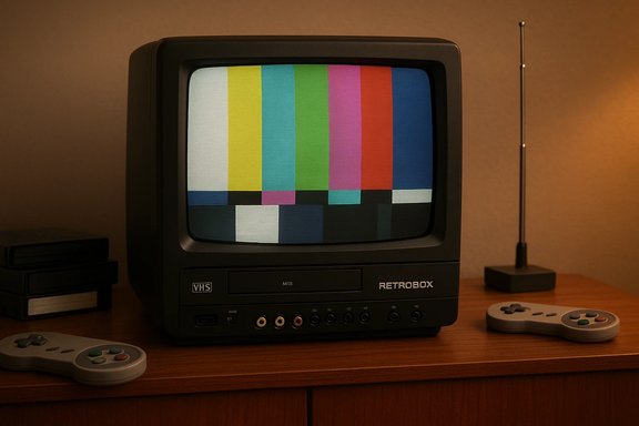

A new wave of nostalgia hardware is on the way: RetroBox has announced a boxed “VHS Combo TV” that pairs a built‑in VCR with a modern flat panel and a broad selection of legacy inputs, promising to “Binge‑watch like it’s 1999.” The product sketches shown so far mix genuine retro functionality (a full videotape mechanism, composite/S‑Video/component/RF inputs and ATSC support) with modern conveniences (HDMI, digital input handling and a 4:3 display that “emulates” CRT behavior), but the available information raises as many questions as it answers—especially for retro gamers, preservationists, and anyone who needs authentic 15 kHz, low‑latency analog handling.
Vintage CRT TV displays color bars on a wooden cabinet, flanked by retro game controllers.Background / Overview​
RetroBox markets the new machine as an all‑in‑one solution: a VCR, a display tuned to classic 4:3 content, and a hub of mixed I/O aimed at both tape playback and retro console/computer connectivity. The company’s promotional materials and early product pages list HDMI, Composite, S‑Video, RF, Component YPbPr, and ATSC inputs, and call out native support for classic video modes such as 240p and 480i in an NTSC 4:3 format. The product is being offered as a presale / “first drop coming soon,” with a retail figure floating around the $399 mark. That combination—mechanical VCR hardware plus modern digital handling and a panel that tries to mimic CRT artifacts—makes RetroBox interesting on paper. It’s obvious why retro gamers and collectors are talking about it: a single, familiar chassis handling original VHS tapes and consoles without multiple adapters would solve a common living‑room problem. But the implementation choices announced so far—above all, using an LCD/OLED (or other modern panel) with software/hardware CRT emulation rather than a real cathode‑ray tube—are the key to whether RetroBox is a clever mainstream nostalgia product or a technical compromise that leaves hobbyists unsatisfied.

RetroBox has been explicit: the product will not use an actual cathode‑ray tube. The company explains the choice by pointing to CRTs’ weight, fragility, limited availability and environmental concerns associated with manufacturing and disposal of CRT glass and phosphors. Instead, RetroBox will use a modern display panel and attempt to mimic CRT characteristics in software and signal processing. The company describes itself as "CRT lovers" trying to reproduce the visual experience as closely as possible, but admits modern panels are more practical for production.
