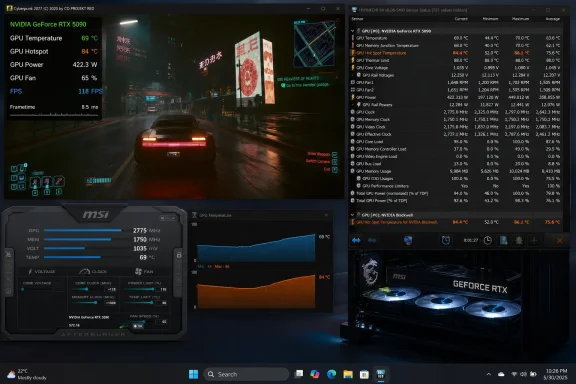

Cyberpunk 2077 runs at 118 FPS while RTX 5090 monitoring shows 69°C GPU temperature and 422W power draw.What you need​

A useful compact layout is:
Code:
GPU: 68 C
Hotspot: 82 C
Power: 310 W
Fan: 62%
FPS: 144

  1. Start a repeatable GPU workload.
  2. Let it run long enough for temperatures and fan speed to stabilize.
  3. Watch both GPU Temperature and GPU Hot Spot Temperature.
  4. Note the difference between them:
Hotspot delta = GPU Hot Spot Temperature − GPU Temperature
For example, if the GPU temperature is 70 C and the hotspot is 84 C, the hotspot delta is 14 C.
Do not use one fixed delta as a pass-or-fail rule. GPU model, cooler design, ambient temperature, workload, power limit, fan curve, and mounting pressure all affect the difference. The new Blackwell readings are also still being validated across utilities, so readings from HWiNFO, HWMonitor, AIDA64, and experimental tools may not match exactly.
A more useful warning sign is a repeatable change: a hotspot temperature or delta that becomes substantially worse at the same power setting, room temperature, and workload.
