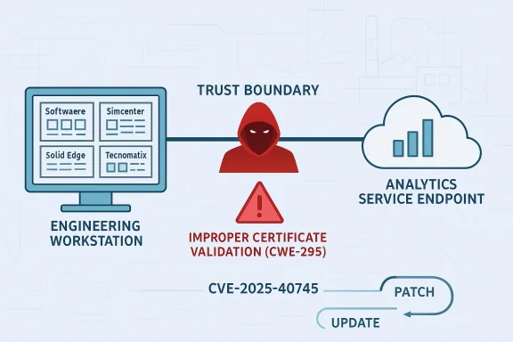

What Siemens Actually Disclosed
The core disclosure is concise: multiple Siemens applications are affected by improper certificate validation in Siemens Analytics Toolkit. Siemens says the flaw could permit a remote, unauthenticated attacker to conduct man-in-the-middle attacks against the Analytics Service endpoint. The vulnerability is tracked as CVE-2025-40745 and mapped to CWE-295: Improper Certificate Validation.What stands out is the difference between the older CVSS 3.1 score and the newer CVSS v4.0 score. Siemens lists 3.7 under CVSS v3.1, but 6.3 under CVSS v4.0. That gap is a reminder that scoring systems evolve, and newer models may better reflect operational concern even when the fundamental bug class is well understood. A low-to-moderate score does not automatically mean low real-world urgency.
The advisory also identifies the reporter: Konrad Porzezynski is credited in the acknowledgments. That matters less for the technical fix than for the disclosure path, but it reinforces that this is a discovered and reported defect, not a speculative interpretation. Disclosure provenance is useful when defenders are trying to judge whether they are dealing with a vendor-confirmed issue or a secondary claim.
Why certificate validation bugs are dangerous
Certificate validation problems often seem abstract until they are mapped onto an actual deployment. If a client accepts a spoofed or improperly validated certificate, it may connect to a malicious endpoint while believing it is talking to the legitimate service. That can expose credentials, configuration data, software packages, and session traffic, depending on how the application uses the TLS channel.In this case, the advisory’s language suggests a pathway to interception rather than direct code execution. That distinction matters. Integrity and confidentiality are the main casualties here, not availability, which means defenders should think about stolen data, poisoned updates, and manipulated responses. A sophisticated attacker can do a great deal with those capabilities even without dropping malware in the classic sense.
- The flaw is remote and unauthenticated.
- The likely abuse case is interception and impersonation.
- The issue centers on an Analytics Service endpoint.
- The vulnerable behavior affects multiple Siemens applications.
- The weakness is categorized as CWE-295.

Why the Risk Is Bigger Than the Score
A 3.7 CVSS v3.1 score looks modest, but this is one of those cases where severity and operational impact can drift apart. The flaw does not need privileges, user interaction, or an existing foothold. It is exposed over the network, and Siemens explicitly says the attacker can be unauthenticated. That combination can still matter a great deal in environments where trust is assumed rather than continuously verified.The score may also understate the value of the target. Engineering applications are often connected to licensing, update, analytics, or cloud-assisted services that are not directly visible in a standard asset inventory. If an attacker can sit between the client and the service, the attacker may be able to downgrade trust, observe traffic patterns, or insert malicious responses. That is not just a privacy problem; it can become an operational integrity problem.
In industrial settings, a man-in-the-middle attack can be a stepping stone rather than the final act. Intercepted analytics traffic might reveal architecture details, license behavior, or update flows that help an attacker plan a second-stage move. Even when no direct exploit chain is documented, the ability to impersonate a trusted endpoint is itself a valuable primitive. That is the part defenders should not minimize.
