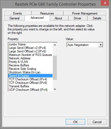

You may want to check the properties of that NIC and under the "Advanced" tab look for something called Speed & Duplex. You may want to experiment with changing it from Auto Negotiate to something like
100 half
and then to
100 full
and see if that has any impact on the issue.
Sometimes certain hardware seems to have more problems with an Auto Negotiate setting.

I tried toggling among Auto Negotiate, 100 half duplex, and 100 full duplex with no impact on speed. My adapter's setting for this was in a separate tab called "Link Speed" and it shows what was negotiated. When in Auto Negotiate it gets 100 full duplex.
