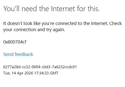

Started getting this error trying to get into Outlook. Have gone through resetting IP address.
Any suggestions on getting rid of error.

Steps 1 & 2 error 0x80070cf pops up. I can get into webmail with no problem. Error message attached.
112,256
Thanks, John — the screenshot shows error 0x800704cf.
That code usually means Windows’ Microsoft sign-in component cannot reach the network/auth service, even though your internet itself is working.
Since:
  • webmail works
  • Outlook fails even with outlook.exe /safe
  • outlook.exe /resetnavpane gives the same result
this is probably not an Outlook mailbox problem. It is more likely a Windows sign-in / cached credentials / proxy / profile issue.

Solution
112,256
Excellent — that fits the error perfectly. A wrong or unsynced system clock can break Microsoft sign-in/auth and trigger 0x800704cf, even when normal web browsing still works.
