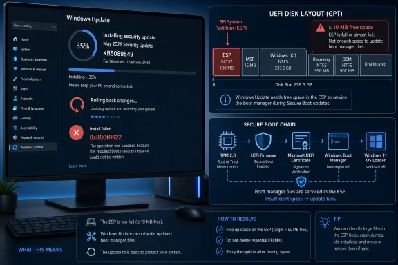

A Security Update Trips Over the Smallest Partition on the Disk
KB5089549 is not a feature experiment masquerading as a patch. It is the May 2026 cumulative security update for Windows 11 24H2 and 25H2, bringing the OS to builds 26100.8457 and 26200.8457 respectively, with security fixes, servicing-stack improvements, and changes tied to Secure Boot and boot-manager servicing. In ordinary Patch Tuesday terms, this is the update administrators would rather install than debate.The problem is that some devices cannot get through the reboot phase. Windows Update can download the package, stage the update, begin the install, and look as though it is progressing normally. Then, at roughly the 35–36 percent mark, the process fails, Windows rolls back the changes, and users are greeted by the familiar non-apology: “Something didn’t go as planned. Undoing changes.”
The visible error code is 0x800f0922, a code Windows veterans have seen in several update contexts over the years. Here, Microsoft’s explanation is more specific than the generic error suggests. The update is failing on systems where the EFI System Partition, or ESP, has limited free space — especially when 10 MB or less remains available.
That makes this less a story about a botched download and more a story about the hidden geography of a Windows PC. The ESP is not the big C: drive where users delete videos and uninstall games to make room. It is the small FAT-formatted partition used by UEFI firmware and Windows boot components, often created years ago by an OEM image, an installer default, or a disk-migration tool.
The EFI Partition Was Never Supposed to Be a User Problem
The EFI System Partition sits below the level at which most people understand their PC. It stores boot loaders, firmware-accessible files, and other components required to start the operating system. If Windows is a city, the ESP is not the apartment building, the shopping district, or the subway map; it is the locked service corridor behind the electrical room.For years, that obscurity was part of the bargain. Users did not manage the ESP because Windows, PC makers, and firmware vendors were supposed to size and maintain it well enough that it stayed out of sight. But modern Windows servicing has become more interested in the boot chain, and the boot chain has become more crowded.
Secure Boot certificate updates, boot-manager fixes, BitLocker interactions, OEM files, diagnostics, recovery tooling, and third-party boot artifacts can all compete for space in a partition that may have been provisioned with yesterday’s assumptions. Microsoft’s own known-issue text points to log entries indicating insufficient ESP space and notes that third-party or OEM files outside Microsoft boot directories may be consuming room.
That is the uncomfortable detail. The system can have hundreds of gigabytes free on the main Windows volume and still fail because a tiny boot partition has crossed an invisible threshold. From the user’s perspective, this feels absurd. From the servicing stack’s perspective, it is brutally logical: the files needed for boot servicing have nowhere safe to go.
Microsoft’s Fix Is Really Two Fixes, and One Is Safer Than the Other
Microsoft’s first mitigation is Known Issue Rollback, the mechanism the company uses to disable specific non-security changes that cause regressions without requiring every affected machine to uninstall the entire update. For consumer devices and unmanaged business PCs, Microsoft says the KIR mitigation has already propagated automatically, though a restart may help it apply faster.That is the path most people should prefer. KIR is boring by design, and boring is exactly what you want when the affected component lives near the boot process. It lets Microsoft back away from the problematic behavior while leaving the broader security update model intact.
The second workaround is a registry modification that changes an ESP-related setting before retrying the update. Microsoft documents a command that adds an
EspPaddingPercent value under HKLM\SYSTEM\CurrentControlSet\Control\Bfsvc, setting it to zero, followed by a reboot and another installation attempt. This is a legitimate Microsoft-published workaround, but that does not make it casual maintenance.The registry path is for administrators, advanced users, and support desks that understand the risk tradeoff. Editing the registry incorrectly can break Windows in ways that are far worse than a failed cumulative update. More importantly, using a registry tweak to squeeze an update through a cramped ESP does not answer the larger question of why the partition is cramped in the first place.
