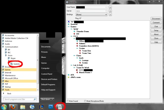

Some of my icons are broken in the start menu but not broken on the taskbar, some are not broken in the start menu but broken on the taskbar, and some are broken in both. How do I fix this?

As well as deleting the iconcache.db, delete your Thumbnail cache files with the Disk Cleanup Utility (Press Start, (My) Computer, Right click C: Drive (your Main or System Drive), Properties, Click on the Disk Clean Up button). Thumbnails is one of the options you can choose to clean up. Re-boot.
Could you give some examples (program names) of what is broken, what isn't?
This should rebuild your icon cache:

lol it seems like all i had to do was close explorer.exe and start it again and it worked.
thanks :D

I usually find more and more corrupted icons from Messengers applications like Windows Live Msn or Yahoo Messenger
After using the solution from kemical icons work again like they should :)
