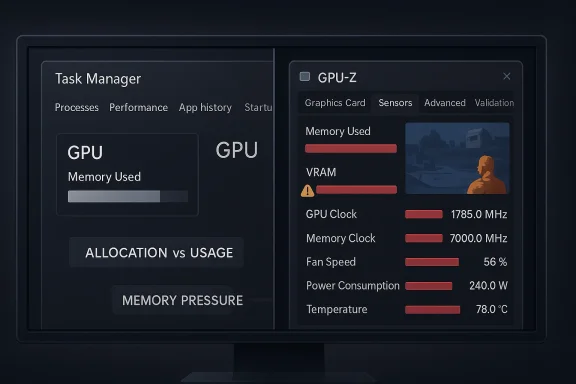

What Task Manager Actually Shows
The GPU memory figures in Task Manager are not meaningless, but they are filtered figures. Windows’ video memory manager, often referred to as VidMm, reports how much physical GPU memory the operating system believes is actively in use, which is not always the same thing as how much memory has been reserved, promised, or staged by applications. That distinction is the heart of the confusion. A game can reserve a large chunk of VRAM for assets it may need later, while Task Manager may only reflect what is currently active in the OS-managed accounting.This explains why people are surprised when performance collapses despite apparently healthy numbers. If the application has already claimed memory for textures, buffers, or caches, the card may be operating close to a practical limit even though the live-use number looks tame. The issue is not that Task Manager is inventing data; it is that it is reporting a narrower slice of memory behavior than most users assume. That narrow slice is often enough for a quick check, but not enough for serious troubleshooting.
Allocation versus usage
This is where the distinction between allocation and usage matters most. Allocation is the memory an app asks for and keeps reserved, while usage is what it is actively touching at a given instant. A 1440p game might allocate 10 GB of VRAM while only burning through 6 or 7 GB in the moment, and that gap is exactly where Task Manager can mislead you. The system can be much closer to saturation than the visible usage number suggests.That matters because stutter often appears before outright exhaustion. When the allocation curve gets too close to the physical ceiling, the driver and OS have to shuffle data more aggressively, and latency rises long before the card truly “runs out.” In practice, that means a user may blame the wrong setting, the wrong driver, or even the wrong game, when the real issue is simply that the memory headroom has been misread. That is a very expensive misunderstanding.
Why the simplified view exists
Microsoft’s choice to expose a simplified view is not irrational. Most users do not want to parse memory reservations, per-process residency, and compositor overhead every time they open a chart. A cleaner display avoids panic and keeps Task Manager accessible. The downside is that the cleaner display can also hide the very thing advanced users need most: the difference between “looks fine” and “is about to fail.”- Task Manager is optimized for quick interpretation.

Why GPU-Z Tells a Different Story
GPU-Z has become the go-to answer because it exposes more of the hardware’s actual behavior. Unlike Task Manager, it does not try to sanitize the sensor feed into a broad consumer-friendly summary. It shows a detailed live view of GPU state, including Memory Used, clocks, power, temperature, and other signals that make it much easier to understand how a card is behaving under pressure. That gives users a more realistic picture of whether they are approaching a VRAM ceiling or merely seeing a temporary spike.The value of that detail is not academic. If a game is starting to hitch, a creative app is crashing during large exports, or a local model is forcing memory contention, the question is rarely “what does the OS think is active right now?” The question is “how much of the card is already spoken for?” GPU-Z is better aligned to that question because it shows the broader footprint rather than the narrow operational slice. That is why it feels more trustworthy in real-world debugging.
What makes it useful in practice
GPU-Z is also appealing because it is lightweight and portable. There is no install ritual, no bundled ecosystem, and no need to learn a complex suite just to inspect a card. You launch it, open the Sensors tab, and immediately get a rolling feed of the numbers that matter. For many enthusiasts, that convenience is the difference between actually checking the data and assuming the game is “just buggy.”It also reports other hardware behavior that helps explain performance dips. Core clocks, memory clock frequency, board power draw, and voltage can reveal whether a card is throttling, boosting correctly, or behaving oddly under load. When memory pressure is only part of the problem, those extra readings matter because a GPU can look “underused” in one sense while being power-limited or thermally constrained in another.
Why allocation visibility changes troubleshooting
The most important contribution of GPU-Z is not that it gives you bigger numbers. It is that it gives you the right numbers for diagnosing the real failure mode. If the card is sitting near physical VRAM limits, you can respond by lowering texture quality, reducing resolution, trimming background capture tools, or adjusting the workload. If Task Manager is your only reference point, you may never realize that the memory problem started much earlier than the visible crash.- It shows a broader sensor picture than Task Manager.
- It makes reserved memory behavior easier to infer.
- It helps distinguish memory pressure from other bottlenecks.
- It is free, portable, and easy to open on demand.
- It is better suited to performance tuning than a simplified dashboard.

The Limits of Task Manager’s GPU Load Percentage
Task Manager’s GPU load percentage has another subtle problem: it can be misleading for compute-heavy workloads. The article notes that its load measurement is tied to memory bus activity relative to bandwidth, which means the percentage does not always translate cleanly to “how busy” the GPU is in the way users expect. A card can appear highly loaded while not actually being in the most performance-intensive state, which can confuse anyone trying to compare charts across tools.This matters because modern users no longer use GPUs just for games. They use them for machine learning, encoding, rendering, and hybrid workloads that do not map neatly onto a single “usage” concept. When the display is built around a simplified proxy, the user can easily infer the wrong bottleneck. A metric can be numerically accurate and still be diagnostically misleading.
Why proxies fail
The problem with proxy metrics is that they flatten different kinds of work into one number. A GPU can be active, but active in a way that is not reflected by the same counters a gamer cares about. That is why a general-purpose percentage is helpful for headlines but weak for diagnosis. It answers “is the GPU doing something?” more than “what exactly is the GPU doing?”The practical consequence is that users may overreact to a high percentage or underreact to a low one. That is the worst possible combination for troubleshooting because it pushes people toward simplistic conclusions. The deeper the workload, the more likely a shallow metric is to obscure the real reason for the slowdown. That is where the confusion becomes expensive.
Better mental model
A healthier model is to treat Task Manager as a coarse health check and GPU-Z as the instrument panel. The first tells you whether the system is broadly alive and roughly where trouble might be. The second tells you what is actually happening under the hood. Once you adopt that distinction, a lot of GPU “mysteries” become much easier to reason about.- Percentages can be proxies, not full explanations.
