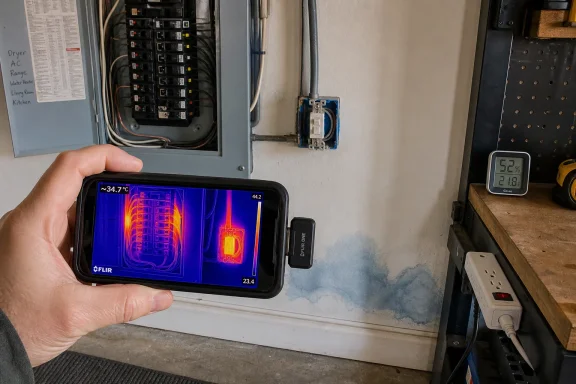

The most compelling examples are domestic because houses hide failure so effectively. A wall can look perfect while water travels behind it. A switch can look normal while a loose connection warms the metal box. A ceiling can appear clean while damp insulation changes temperature in a pattern no coat of paint can conceal.That is why thermal cameras fit so naturally into energy audits. Heat loss around doors, windows, rooflines, attic hatches, and poorly insulated wall sections often produces visible thermal contrast. A homeowner does not need a full building-science credential to understand that a bright or dark streak at the wrong place deserves investigation.
Moisture is more subtle. A thermal camera does not see water as water, and it does not see mold hiding inside a wall. It sees surface temperature differences that may be caused by evaporation, changed thermal mass, missing insulation, air movement, or something else entirely. That limitation is not a reason to dismiss the tool; it is a reason to treat it as a pointer rather than a verdict.
Plumbing leaks follow the same logic. Wet materials store and release heat differently than dry ones. Under the right conditions, that difference can reveal a hidden path of water before staining, rot, or swelling becomes visible. Under the wrong conditions, it can mislead. The camera starts the inquiry; moisture meters, pressure tests, visual inspection, and common sense finish it.

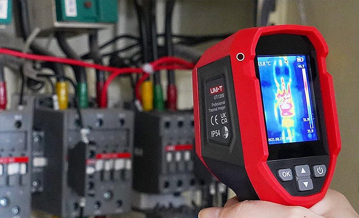

Electrical work is where the stakes rise. Resistance creates heat, and poor connections, overloaded conductors, failing breakers, and damaged components can all show thermal anomalies. But this is also where amateur confidence becomes dangerous. A thermal image can justify calling an electrician sooner; it should not justify poking around live gear without training.
