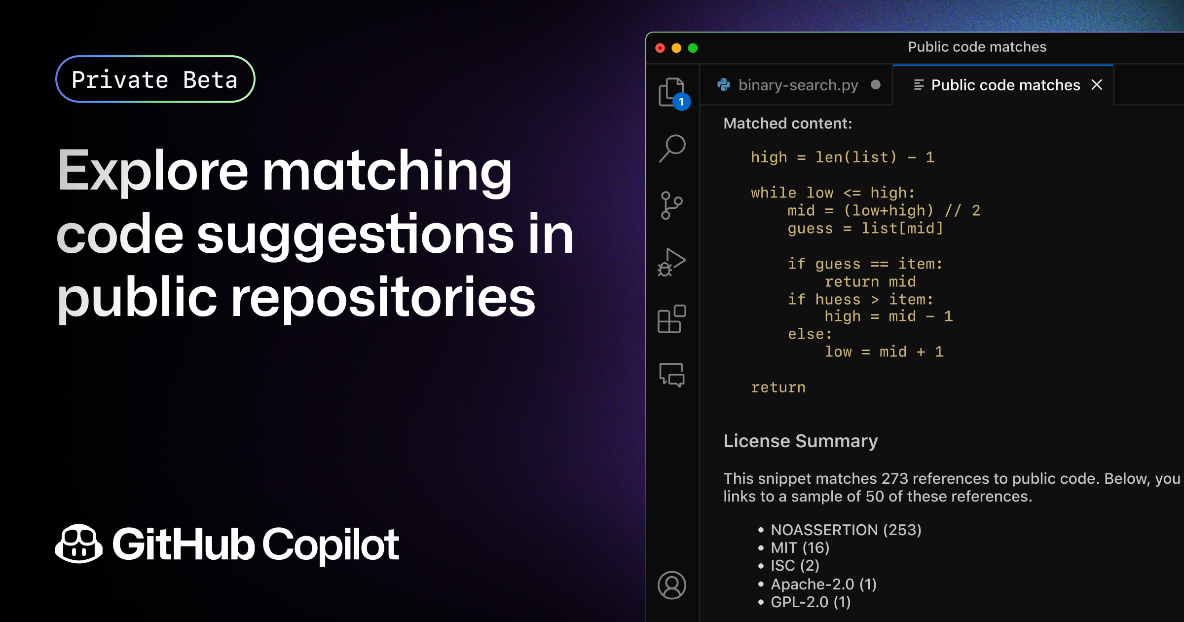

GitHub’s matching-public-code controls are a useful example of where vendors are heading. Copilot can be configured to block or reference suggestions that match public code, and GitHub has described code referencing features that show repositories and licences when matches occur. Those are not substitutes for legal judgement, but they are signals that provenance belongs inside developer workflow rather than in a quarterly training deck.

Introducing code referencing for GitHub Copilot - The GitHub Blog
Today, we’re announcing a private beta of GitHub Copilot with code referencing that includes a filter to detect code suggestions matching public code on GitHub.github.blog
