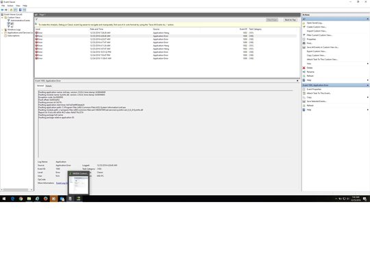

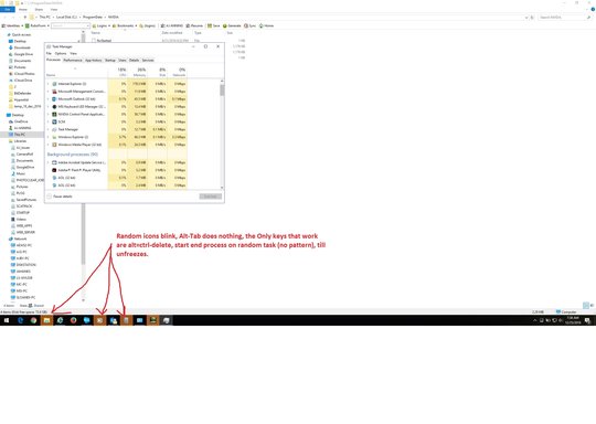

I am using the latest version of Windows 10, pro 64 bit. Windws starts normally, however, after I am logged in
for a few minutes, checking email, going to a WEB site, Windows "freezes"
The mouse will turn into a small spinning circle, as if it is processing something and
The icons in the left side of the task bar will blink, and the PC is totally locked.
(see wi_1.jpg)
Hitting any of the keys does nothing, ALT/TAB does nothing. If I hit ALT/CTRL/DEL
and from the task manager, end process on Random processes, this resolves the issue,
only for all of the above issues happen again.
I have screen shots and saved even view files at:
www.aanning.com - /ajissues/Windows_errors/freeze/
Files:
event_view1.evtx (event viewer saved)
event_view2.evtx (event viewer saved)

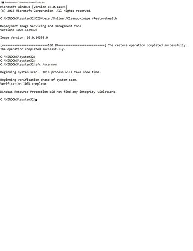

I'm on UVERSE..its semi Fiber...52 meg down and 6 meg up, I just piggy back AOL on that..for 15+ years now. WOW dial up...as Obe Wan said "That's a name I have not heard in a long long time". Anyway, I did as much as I could from what you sent
http://www.aanning.com/ajissues/Windows_errors/freeze/DISM_sfc_1.jpg
SFC and DISM ran without issues, I'll have to wait now, for the random freeze to occur..or hopefully it will not.

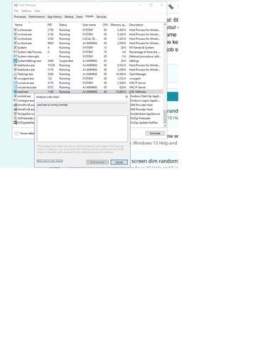

Sorry, analyze wait chain can be accessed from the details tab. Also you don't need AOL's software to access your email any email client can access it.

Right, I found it...nothing came back. The issue Just happened, I wrote a batch job and icon to kill AOL without having to go to task manager. When it freezes..none of the keyboard works..can not alt tab...I can alt ctrl del to task manager, or windows key/D, to desk top where now my icon for the kill AOL batch job sits. As I said, the issue just occurred, killed AOL with my batch job and did analyze chain...nothing usefull there.
http://www.aanning.com/ajissues/Windows_errors/freeze/Analyze_waitChain_1.jpg
