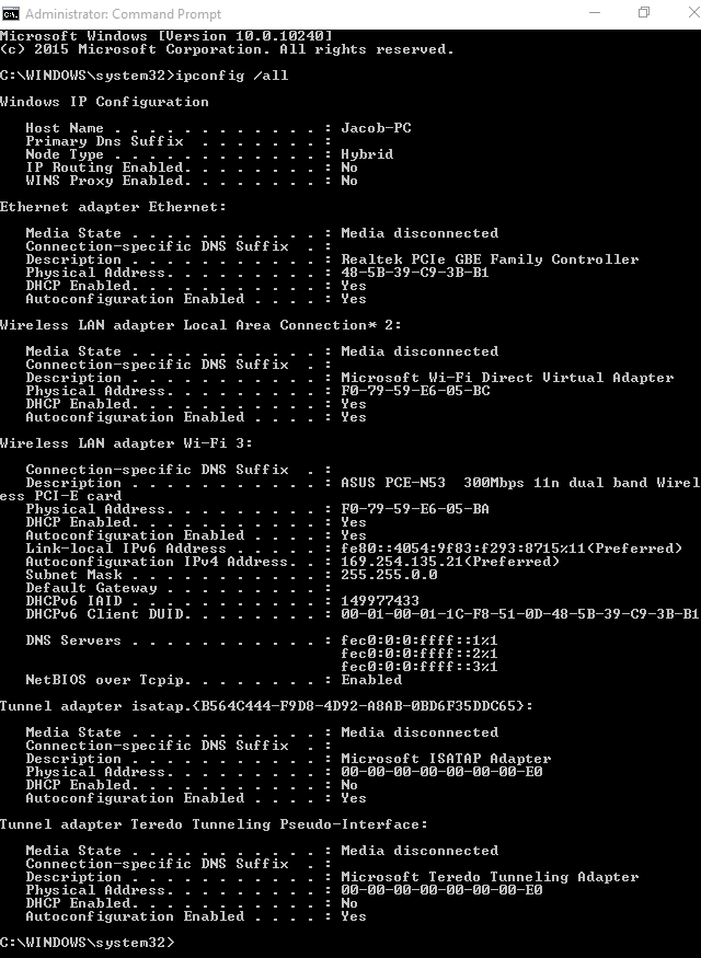

At the time you did ths ipconfig /all... the network wasn't up so you get the default 169 address which just means nothing found.
Thanks ussnorway, I did not realize that this number was a reserved number.

Hey Jacob,
I am not quite sure that I understand how your network has been built up
There must be a modem/router brand Belkin, to connect you with your ISP, and you are trying to connect to it?
Or are you connecting to some other wireless connect point, the iPhone hotspot? And if so, how is that connected with the router?
Could you also tell us what ipconfig /all tells you?

It is the Wireless Lan adapter 3 that is being used and it has no default gateway and it should have, and your TCPIP address is not what you normally see an 'inside' 192.168 number.
These parameters are normally set when you select Automatic in your TCPIP v4 properties setting of the wireless connection. These values come from the router at startup when the router has DHCP enabled.
Both the wireless and the wired ethernet TCPIP v4 settings should be set to Automatic!
