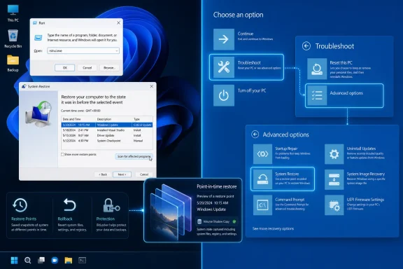

Windows 11 can be restored to an earlier working state by launching System Restore with
That distinction matters because “restore Windows to an earlier date” sounds broader than it is. As Microsoft’s own recovery documentation makes clear, classic System Restore is a system-state rollback tool, not a time machine for every file on the disk. And with Microsoft now previewing Point-in-time restore for newer Windows 11 builds, the recovery story is getting more capable — but also more fragmented.
For all the Settings redesigns and recovery menus Microsoft has layered into Windows 11, the quickest way into classic System Restore remains stubbornly old-school: press Windows logo key + R, type
From there, the process is deliberately conservative. Choose a restore point, use “Scan for affected programs,” review what Windows expects to remove or restore, and then confirm. Windows restarts, replaces monitored system files and registry state with the selected snapshot, and attempts to return the operating system to the condition it was in at that point.
That “Scan for affected programs” button is not decorative. It is Windows admitting that a restore point can roll back installed applications, drivers, and system changes that landed after the selected date. If a GPU driver, VPN client, shell extension, printer package, or security tool was installed after the restore point, it may disappear or require repair after the rollback.
The conventional route still exists too: Control Panel, Recovery, Open System Restore. It is slower, but it is the more discoverable path for users who do not know the
The practical advice is simple: if Windows still boots, start with

If the PC still reaches the sign-in screen, the cleanest path is to hold Shift while selecting Power and then Restart. If the machine cannot get that far, repeated interrupted startups may trigger automatic repair and expose the recovery screen. A recovery drive or Windows installation media can also get a broken machine into the repair environment.
The path is then Troubleshoot, Advanced options, System Restore. Windows may ask the user to select an account, enter credentials, and then choose from available restore points. On BitLocker-protected systems, the recovery key may be required before the drive can be accessed.
That BitLocker prompt is not a corner case anymore. Modern Windows 11 PCs, especially those using device encryption or business security baselines, can easily require a recovery key when booting into offline repair modes. Anyone responsible for a fleet — or even a household laptop — should know where that key is stored before disaster arrives.
Running System Restore from WinRE is often the better choice when a driver or boot-start service has made Windows unstable. Because the installed OS is offline, fewer files are in use and fewer third-party services are active. The recovery environment gives Windows a quieter operating room.

The Restore Menu Is Really a Decision Tree
Before clicking the most dramatic recovery button, match the symptom to the tool. The goal is not to use System Restore at all costs. The goal is to lose the least time, the least configuration, and the least data.- Use
rstrui.exefirst when Windows still starts and the problem followed a driver, app, setting, or local system change. - Use Windows Recovery Environment when the PC will not boot, and expect BitLocker to require a recovery key on protected devices.
- Use Uninstall updates when the failure appeared immediately after a Windows quality update or feature update.
- Use Go back only for a recent Windows version upgrade, and remember that the rollback files and the 10-day window are both perishable.
- Turn on System Protection before the next failure, because System Restore cannot restore to a point that was never created.
- Treat Point-in-time restore as a promising newer rollback layer on supported Windows 11 PCs, not as a replacement for real backups.
