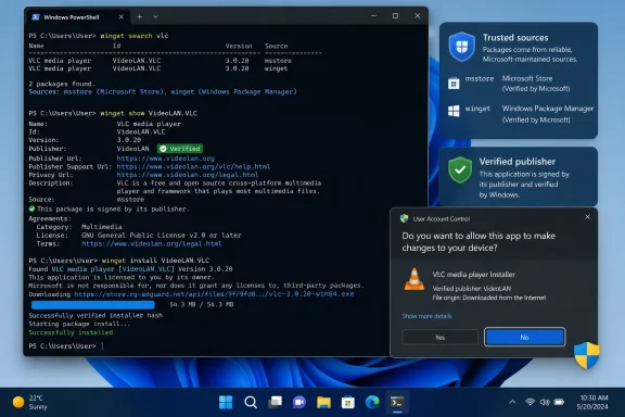

winget --versionSearch for the correct package
Usewinget search before installing. A basic search matches text in package names, IDs, descriptions, monikers, and tags.For example, to find VLC:
winget search vlcThe results normally include columns such as Name, Id, Version, and Source. Read all of them. A search can return:

Inspect the package before installing it
Once you have identified an ID, inspect its published metadata and the installer thatwinget selects for your PC:winget show --id VideoLAN.VLC --exact --source wingetReplace
VideoLAN.VLC with the ID you found.Check that the displayed package name and publisher are what you expect. This is particularly important when search results have similar names. The
show command displays available metadata and the installer information selected for the current device; not every package submission includes every field.If the package is from Microsoft Store, use its Store ID and source instead:
winget show --id <Store-ID> --source msstoreInstall an app using its package ID
Install the confirmed VLC package with:winget install --id VideoLAN.VLC --exact --source wingetThis is preferable to:
