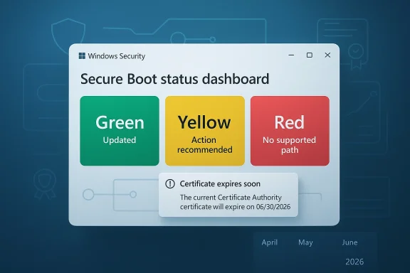

Microsoft is turning one of Windows’ most invisible security foundations into something ordinary users can finally see. Starting in April 2026, Windows Security will surface a Secure Boot status dashboard that tells users whether their PC has already received Microsoft’s newer certificates, whether action is recommended, or whether the device may be stuck on an aging trust chain that can no longer be serviced normally. The timing is no accident: Microsoft has been warning that the original Secure Boot certificates issued in 2011 begin expiring in June 2026, and the new status view is meant to make that transition understandable before it becomes urgent.
The headline sounds modest, almost routine, but the underlying change is significant. Secure Boot is part of the earliest layer of trust in a Windows PC, helping ensure that the machine only starts trusted code during the boot process. When that trust chain ages out, the system may still appear to work normally while quietly losing the ability to accept future boot-level protections, which is exactly the kind of problem that tends to become visible only after attackers exploit it.
That is why Microsoft’s new dashboard matters. It reduces a deeply technical firmware transition into a simple color-coded status inside the Windows Security app: green for updated, yellow for recommended action, and red for no supported path forward. In practical terms, that means users no longer have to guess whether the update happened or whether their device is depending on an OEM firmware step they have not yet taken.

What the status colors mean
The green state means the device has received the updated certificates and no further action is needed. Yellow means the PC still has a path forward, but Microsoft recommends some sort of follow-up, often through Windows Update or an OEM firmware update. Red means the device cannot receive the updated certificates in its current configuration, which may limit future boot-level security fixes.That color system is deliberately simple, and that simplicity is the point. Users do not need a lecture on PKI, KEK, DB, or DBX just to know whether their PC is protected. They need a plain-language answer, and Microsoft is trying to compress a complex firmware lifecycle into something visible at a glance. The challenge, of course, is that the right next step may still require an OEM firmware package rather than a standard Windows patch.

Why the red state matters
The red state is the most serious because it does not mean the machine is dead. It means the device cannot receive the updated trust material needed to keep future boot protections viable. That is a subtle but important difference, and Microsoft seems to be trying hard to avoid panic while still making the risk plain.A PC in that state can still boot, still browse, and still run applications. What it may lose is the ability to stay current at the lowest levels of startup security, which is where bootkits and other persistent threats live. That is why the issue is serious even though it is not instantly visible to the user. It is less dramatic than a blue screen, but arguably more consequential over time.

What the Windows Security dashboard changes
The real product change here is not the certificate rollout itself. It is the fact that Windows Security is now the front door for a firmware trust question that most users would otherwise never inspect. Microsoft is effectively taking a back-end lifecycle issue and giving it a consumer-friendly face.That matters because user attention is scarce. If a problem is hidden in firmware menus or buried in documentation, most people will never see it until support techs are already involved. By putting the status into a familiar security app, Microsoft lowers the friction for checking, interpreting, and acting on the problem. That is good design, even if the underlying issue is complicated.
A dashboard that doubles as remediation guidance
Microsoft says the status page does more than show a color. It also provides explanatory text that points users toward the right action, whether that is a Windows Update, an OEM firmware update, or no action at all. That extra context is crucial because the remediation path is not the same for every machine.A yellow badge may simply mean the device needs more time to receive the payload through normal servicing. It may also mean the motherboard maker has to release compatible firmware before the update can take effect. That distinction is why Microsoft’s simplified UI is still paired with deeper guidance, because a single badge cannot capture every hardware-specific dependency.
