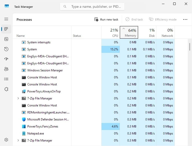

Windows 11​
  • Press Ctrl + Shift + Esc to open Task Manager.
  • If Task Manager opens in compact view, select More details.
  • Select Processes.
  • Find Windows Explorer.
  • Right-click Windows Explorer.
  • Select Restart.
  • Wait a few seconds for the taskbar and desktop to reload.
  • Test drag and drop again.

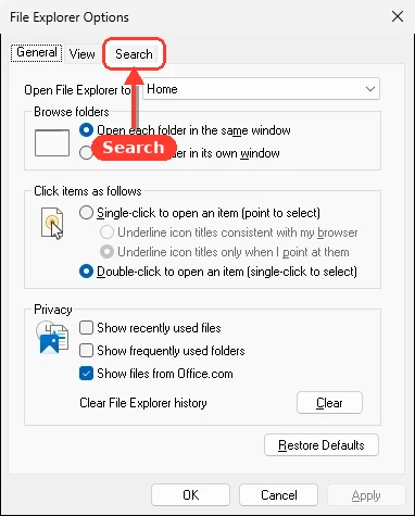

6. Reset File Explorer Options​
Incorrect or corrupted File Explorer view settings can occasionally cause odd folder behavior. Resetting folder options is safe and does not delete your files.
  • Open File Explorer.
  • Select the three dots menu in Windows 11, or the View tab in Windows 10.
  • Choose Options or Change folder and search options.
  • On the General tab, select Restore Defaults.
  • Go to the View tab.
  • Select Reset Folders if available.
  • Select Restore Defaults.
  • Select Apply, then OK.
  • Close and reopen File Explorer.
  • Try drag and drop again.
