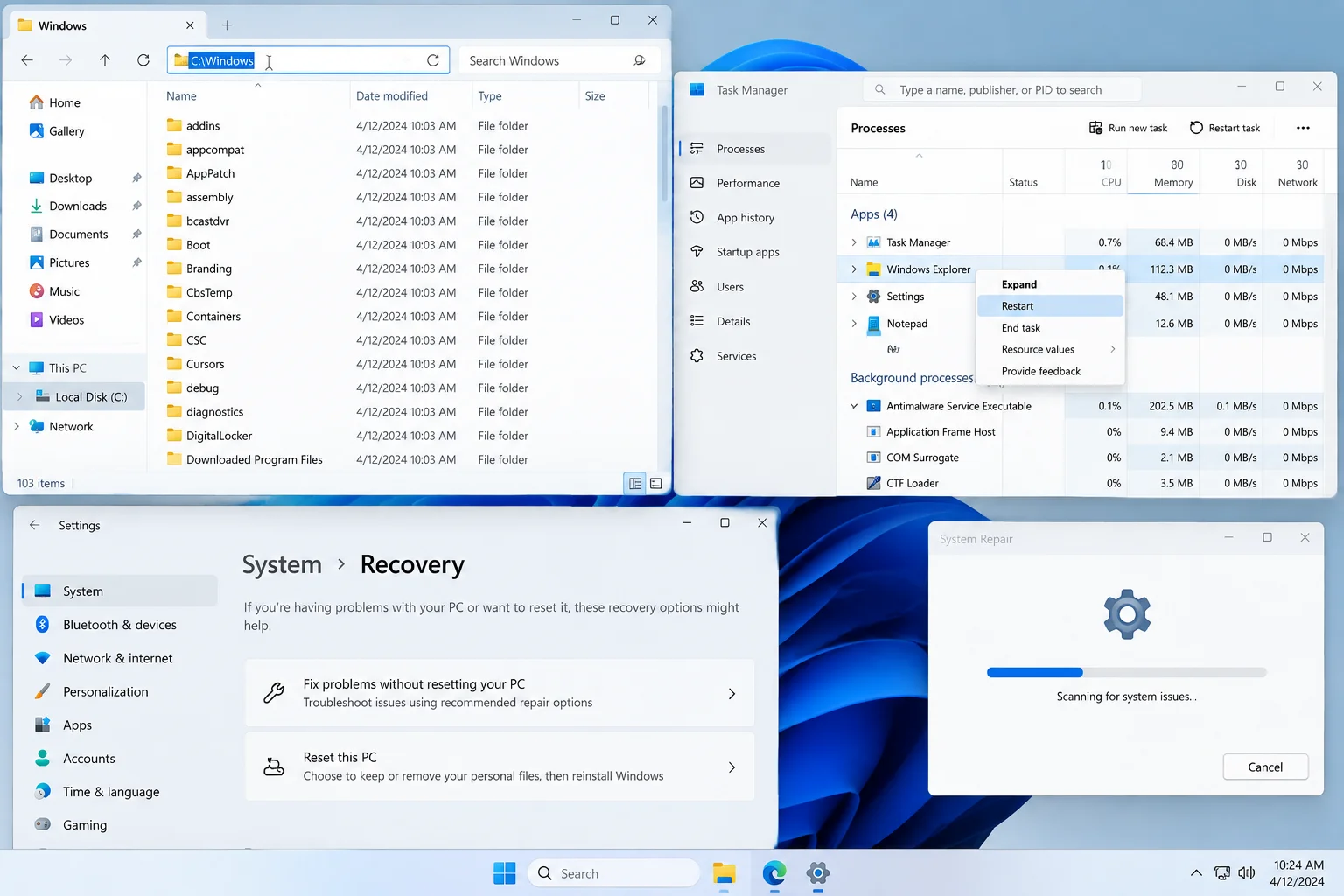

A File Explorer address bar that will not accept typing, pasted paths, or navigation commands is usually a stuck Explorer process, damaged folder-view configuration, interference from non-Microsoft startup software, or corrupted Windows components. The steps below apply to supported Windows 11 and Windows 10 installations. Start with restarting Explorer, then reset File Explorer settings, test for a software conflict, and finally repair Windows with DISM and System File Checker.
Windows 11 shows File Explorer, Task Manager with the Explorer restart option, Recovery settings, and a system repair scan. Confirm that the address bar itself is the problem​

Restart File Explorer​
Restarting Explorer reloads the Windows shell, including the taskbar, desktop, File Explorer windows, and address bar. It does not close documents in other applications, but open File Explorer windows will close.
  • Save any file work that is currently open in File Explorer or another app.
  • Press Ctrl + Shift + Esc to open Task Manager.
  • If Task Manager opens in the compact view, select More details.
  • In the Processes tab, find Windows Explorer.
  • Right-click Windows Explorer, then select Restart.
Windows 11 Task Manager window showing the Processes view
The taskbar and desktop may disappear briefly. Wait for them to return, then open File Explorer again with Windows key + E.
  • Click in the address bar or press Ctrl + L.
  • Enter a local path such as C:\Users and press Enter.
  • Copy another local path, click the address bar, and press Ctrl + V to test pasting.
