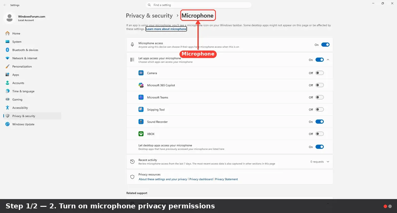

2. Turn on microphone privacy permissions​
Windows 11 Settings on the Privacy & security > Microphone page with the microphone access toggle and the per-app 'Let apps access your microphone' list
A microphone can be working flawlessly while Windows prevents an app from using it. Privacy controls are designed to stop unwanted listening; the downside is that they can also stop wanted recording.
In Windows 11​
Go to Settings > Privacy & security > Microphone, then confirm:
  • Microphone access is turned on.
  • Let apps access your microphone is turned on.
  • The relevant Microsoft Store app is allowed, where it appears in the list.
  • Let desktop apps access your microphone is turned on for desktop recording software.
In Windows 10​
Go to Settings > Privacy > Microphone, then enable:
  • Allow access to the microphone on this device
  • Allow apps to access your microphone
  • Access for the recording app, if Windows lists it
Microsoft notes that desktop apps are not always shown as individually switchable entries. The broader desktop-app microphone permission can therefore be the setting that decides whether an otherwise healthy microphone reaches the recorder.
