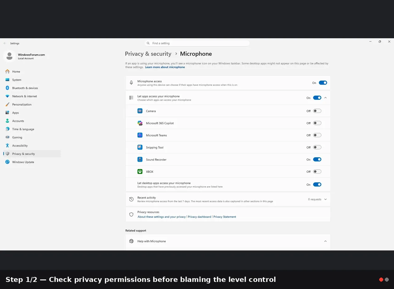

Check privacy permissions before blaming the level control​
Windows 11 Settings on the Privacy & security > Microphone page with the microphone access toggle and the per-app 'Let apps access your microphone' list
Privacy permissions do not usually make a working microphone quieter, but an app may appear to have a volume problem when it is blocked from accessing the microphone or has access to a different device.
Windows 11​
  • Open Start > Settings > Privacy & security > Microphone.
  • Turn on Microphone access.
  • Turn on Let apps access your microphone.
  • If the affected app appears in the list, ensure its switch is on.
  • Turn on Let desktop apps access your microphone for classic desktop programs that need it.
