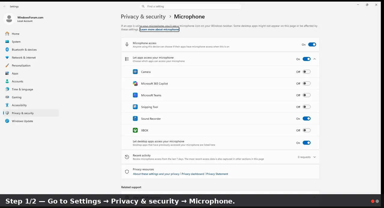

4) Fix Microphone privacy permissions (3 minutes)​
Privacy settings can block all apps (or specific apps) from using the mic.
Windows 11​
  • Go to Settings → Privacy & security → Microphone.
  • Turn Microphone access On.
  • Turn Let apps access your microphone On.
  • Ensure the specific app (e.g., Teams, Discord) is allowed in the app list.
  • If you’re using a browser-based app, also enable Let desktop apps access your microphone.
Windows 11 Settings on the Privacy & security > Microphone page with the microphone access toggle and the per-app 'Let apps access your microphone' list
Windows 10​
  • Go to Settings → Privacy → Microphone.
  • Click Change and ensure Microphone access for this device is On.
  • Turn Allow apps to access your microphone On.
  • Scroll down and enable the specific app.
  • Also ensure Allow desktop apps to access your microphone is On if needed.
Note: “Desktop apps” includes classic Win32 programs like Discord, OBS, some versions of Teams, and many third-party recorders.
