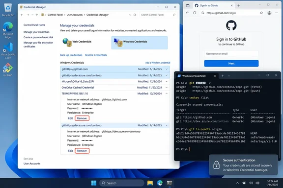

Windows Credential Manager, GitHub login, and PowerShell commands are shown on a Windows desktop.What Git for Windows stores for HTTPS remotes​

Find and remove an outdated GitHub or Azure DevOps entry​
Use the graphical route if you want to inspect entries before removing them:
  1. Open Control Panel, then select User Accounts and Credential Manager.
  2. Select Windows Credentials, not Web Credentials.
  3. Expand entries beginning with git: and identify the host or organization you need to reset.
  4. Choose Remove for the obsolete entry.
For GitHub.com, the target will often be git:[GitHub · Change is constant. GitHub keeps you ahead. · GitHub](https://github.com). For Azure DevOps, look for the entry containing the organization, such as git:[url]https://dev.azure.com/contoso[/url]. Remove only the entry for the service or organization that is failing if you use more than one account.
Credential Manager generally does not show a token’s full value, and that is by design. Treat the target name as the identifier for the host or organization, not as a readable audit record of which GitHub user or Azure DevOps identity owns it.
The command-line method is faster when you know the target name. First list Git-related credentials:
cmdkey /list | findstr /i "git"
Then delete the precise entry:
cmdkey /delete:git:[GitHub · Change is constant. GitHub keeps you ahead. · GitHub](https://github.com)
For Azure DevOps, substitute the organization:
cmdkey /delete:git:[url]https://dev.azure.com/contoso[/url]
Use the target exactly as cmdkey /list displays it. Do not run a broad deletion command copied from another machine: removing every git: entry can force reauthentication across GitHub, Azure DevOps, GitLab, and internal Git servers.
Deleting an old entry is usually preferable to trying to overwrite it manually. On the next successful HTTPS authentication, GCM can store the correct browser-authorized token or credential in the format the provider expects.
