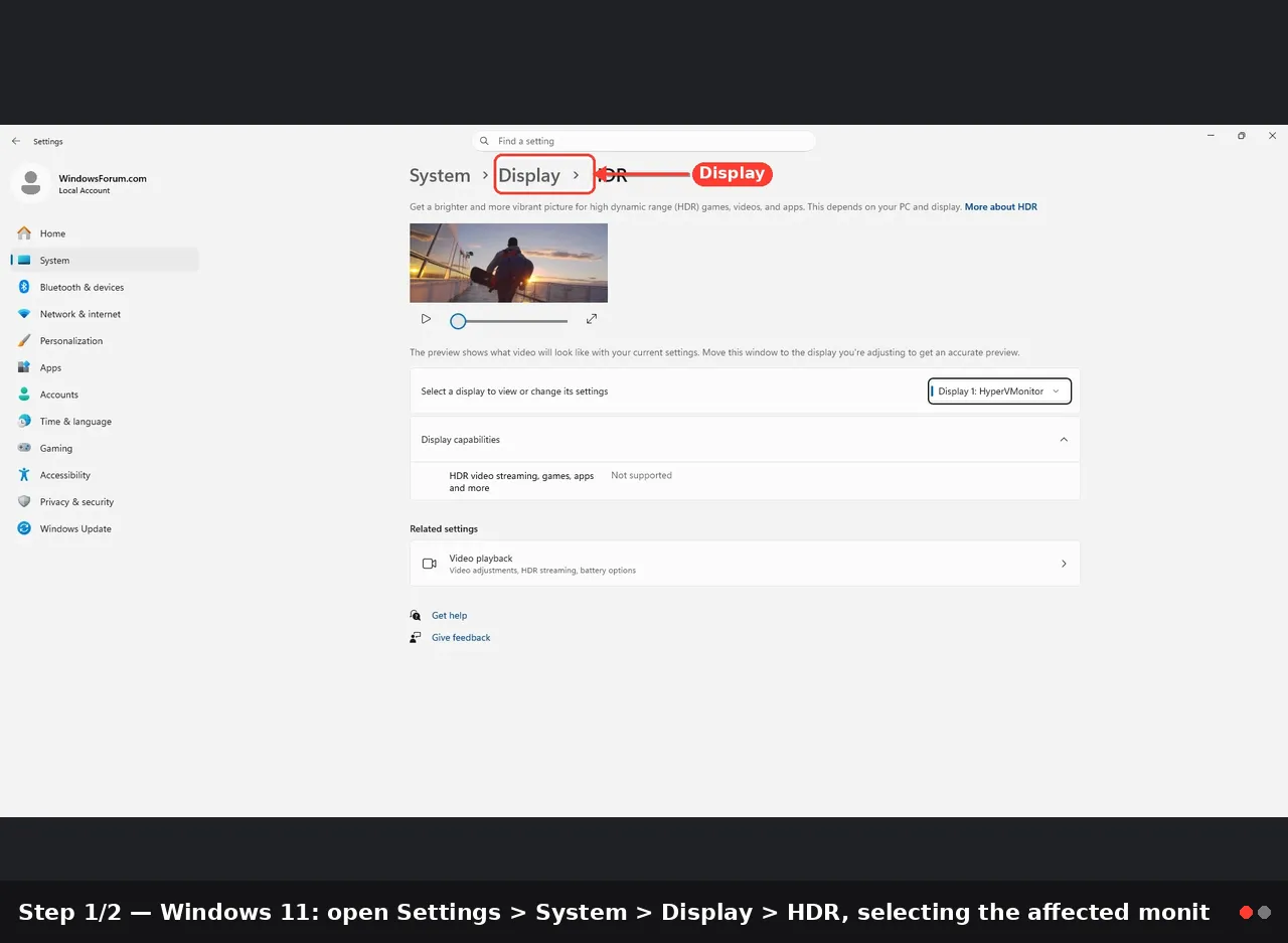

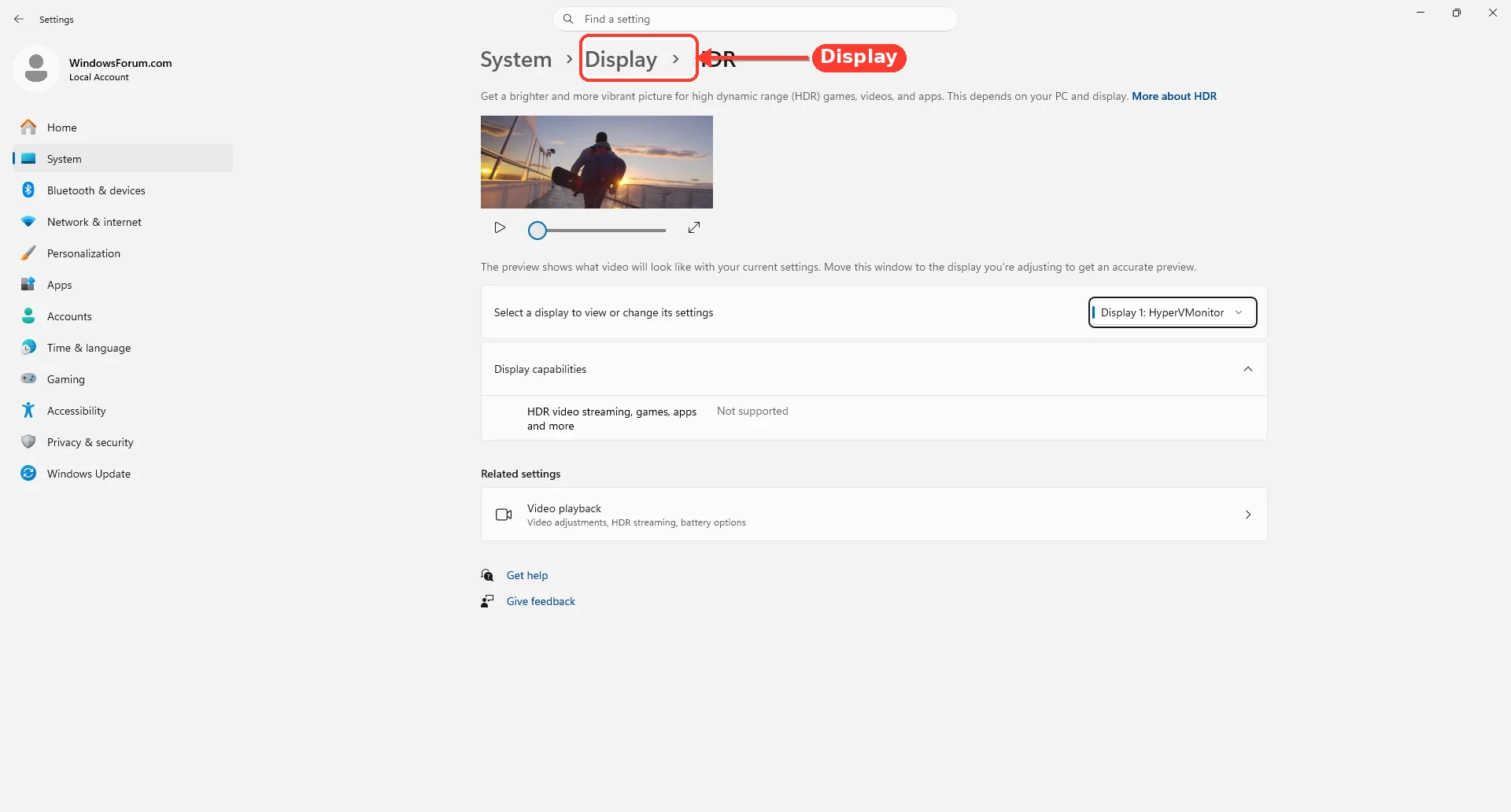

  • Windows 11: open Settings > System > Display > HDR, selecting the affected monitor where necessary.
  • Windows 10: open Settings > System > Display, select the HDR display, and use Windows HD Color settings where shown.
  • Turn Use HDR off temporarily.
  • Recheck your SDR profile and compare the same content in the same application.
  • Turn HDR back on and repeat the comparison. Restore your original HDR state after testing.
Settings opens to the HDR display page, where HDR-related controls such as Auto HDR appear only when the selected display and system support them.

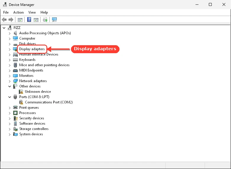

If the issue began immediately after a graphics-driver update, test a rollback rather than uninstalling several display components.
Warning: save your work first. Driver rollback requires administrator permissions. Record the installed driver version so you can return to it if the older driver does not help.
  • Right-click Start > Device Manager.
  • Expand Display adapters.
  • Right-click the relevant adapter and select Properties.
  • Open Driver and record Driver Version.
  • Select Roll Back Driver and follow the prompts.
  • Restart Windows.
  • Recheck the profile association and repeat the original failure test.
Device Manager showing the computer's hardware device categories in a tree.
If Roll Back Driver is unavailable, Microsoft says Windows has no previous driver available for that operation. Obtain an appropriate driver from the device manufacturer instead. To reverse an unsuccessful rollback, reinstall the previously recorded driver using the manufacturer’s supported installer.
