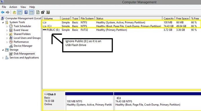

When I go to Control Panel>Administrative Tools> Computer Management>Storage then Disk Management I see this:
Link Removed
So my question is there a way to combine the volume that says "Healthy (System, Active, Primary Partition)" and "(C:) Healthy (Boot, Page File, Crash Dumps, Primary Partition)," so that it doesn't cause my computer not to be bootable or mess up Windows 8? What I mean is to combine then as one, so that instead on in Computer Management it shows then a one partion instead of two like it is now, because I want to create a recovery partition on my hard drive.

Do not mess with the 100 mb partition, that's your boot order (MBR). Leave that alone. You can still partition your C drive, but I would advise against it as it only has 49 gigs left of free space. Install a larger drive if this is a laptop or if this laptop has space for a 2nd hard drive, I'd do that. If a desktop just add a 2nd hard drive, then partition to your liking.

Okay I merged the two back when I had Windows 7 with no problems, but since you helped me before with success I'll take your advice and leave it alone. Theoretically what would happen if I messed with the 100MB partition? My computer wouldn't boot at all? I'm not sure if my laptop has space for another hard drive, but it does have expansion ports.

Yes...with out the boot order you wouldn't be able to get back into your OS and a reinstall would be in order.

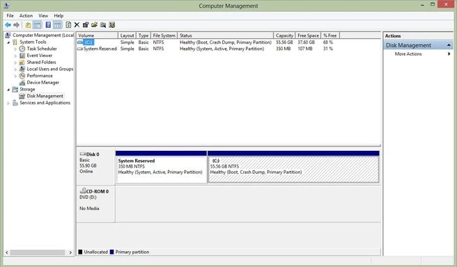

Just curious as to why you are so intent on recovering a small amount of disk space (100MBs)? Also, that partition in question looks like it was created during a Windows 7 installation (and maintained throughout the Win 8 installation) because a legacy "clean install" Windows 8 installation creates a 350MB sytem partition:
Link Removed
Also note that 243MBs of my 350MB system partition has been populated with information.

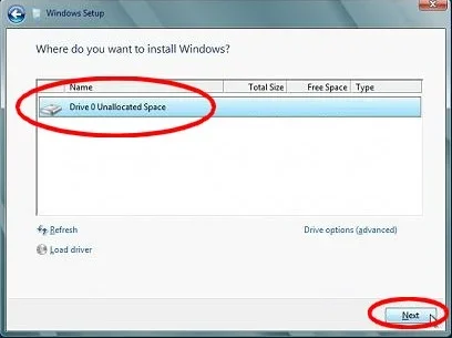

Well, you just taught me that a clean install of Windows 8 (legacy) reacts differently; in that, it can create either a 100MB or 350MB system partition based on unknown circumstances. So, before I go off and try to thoroughly investigate why this variance might happen, please confirm that you deleted all existing partitons and allowed the Win 8 installation process to automatically select the partition configuration for you (as shown below):
Link Removed
