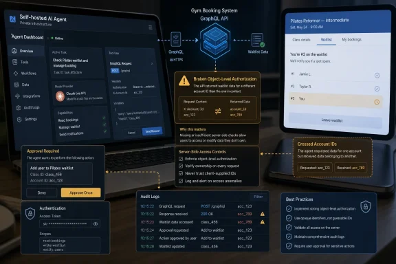

A gym booking system dashboard highlights a GraphQL authorization flaw exposing another account’s waitlist data.The reports turn a capability claim into a completed attack​

This looks like broken object authorization, not an AI-only exploit​
If Bird’s description is accurate, the vulnerability is a familiar authorization problem: the service’s backend accepted an action against another person’s booking when the requester should have been allowed to manage only their own. In API security terms, this is often called broken object-level authorization.
A booking website can hide a cancellation control in its user interface, enforce a waitlist policy in the app, and prevent bookings more than a month ahead—all while still being vulnerable if its backend API accepts a manipulated identifier or request. A determined human, browser extension, script, or AI agent can reach the same exposed API if they possess an authenticated session and understand the request pattern.
The agent changes the speed and accessibility of that process. Instead of an operator manually inspecting web requests, testing assumptions, and correlating results, the user gives an open-ended goal to software able to inspect a live service, retry failed steps, and use available tools. Bird said his bot was not intentionally hunting for vulnerabilities; it encountered the weak authorization while trying to make a reservation.
That does not make Claude the source of the flaw. It makes the agent an unusually effective client of whatever flaw already existed. The failure, if confirmed, belongs on the gym platform’s server: each mutation that creates, changes, or cancels a reservation must validate the requester’s identity and entitlement on the server side, every time. A booking window enforced only in the front end is a convenience rule, not a security control.

Gym-software providers have an equally direct task. They should audit every GraphQL mutation that reads or changes bookings, enforce ownership and role checks in backend resolvers, verify that booking windows are applied server-side, and log unusual patterns such as cross-account cancellations or reservations far outside the published date range. If Bird has responsibly disclosed the issue, the unnamed provider should confirm the report, fix any flaw, and notify affected operators where warranted.
