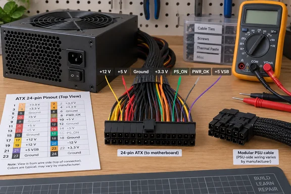

Illustrated PC power-supply testing setup with an ATX pinout, multimeter, and labeled voltage wires.

The ATX 24-pin color code, wire by wire​
Several pinout references reproduce the colors from Intel's design guides, and they agree on the core mapping. Intel's 1998 ATX power supply design guide lists the same set, including two colors that XDA's shorter list leaves out: white and brown.
ColorSignalWhat it does
BlackCOM (ground)Common return path, not a voltage rail
Orange+3.3 V DCMain 3.3 V output
Red+5 V DCMain 5 V output
Yellow+12 V DCMain 12 V output
Blue−12 V DCLegacy negative rail
Purple+5 VSBStandby power while the PSU is plugged in
GreenPS_ON#Motherboard's "turn on" request
GrayPWR_OKPSU's "power good" status
White−5 V DCLegacy rail, optional on newer supplies
Brown+3.3 V senseRemote voltage sensing, where present
A 24-pin ATX12V pinout table describes the green wire as Power Supply On (active low). "Active low" means the PSU turns on when the line is pulled to ground, and a reference guide notes that when the line is connected to GND (by the motherboard), the power supply will turned on. It is internally pulled up to +5 V inside the power supply. In normal use, PS_ON# is activated by motherboard when you press and release the computer power button while it is in standby mode.
The gray wire carries the signal the other way. The same pinout table calls PWR_OK a status signal generated by the power supply to notify the computer that the DC operating voltages are within the ranges required for proper computer operation. It remains low for a brief time (100–500 ms) after the PS_ON# signal is pulled low. The idea goes back to the original IBM PC, whose supply, according to IEEE Spectrum, provided a "power good" signal when all four voltages were correct. PWR_OK tells you the PSU's outputs are in range. It says nothing about the health of the rest of the system.
Purple is the standby rail. Instructables' bench-supply guide explains that it always has 5V available, even if the PSU is turned off, as long as it is plugged in to the AC mains. Brown, where present, is a sense line, not a power line. +3.3 V sense should be connected to the +3.3 V on the motherboard or its power connector. This connection allows for remote sensing of the voltage drop in the power supply wiring.
The main connector's size has changed too, while the colors stayed the same. The original ATX systems had 20-pin main connector P1. When PCI Express® bus was introduced, PCIe cards needed up to 75W extra. To provide the additional wattage, the old part has been replaced by a new 24-pin P1.

Why modular PSU cables break the color logic​
The color code only helps with cables that are fixed to the PSU, where you can follow a wire from the unit to a known pin on a standard connector. Modular supplies add a second connector at the PSU end, and nothing standardizes that side.
Corsair says so plainly in its builder guidance: Connectors on the component side are standardised and therefore all have the same wiring on each PIN. On the power supply side, however, each manufacturer is free to choose how this is applied. Its warning is equally direct: never try to use one brand's cables with another brand's PSU. Doing that could be dangerous to you and your components.
Staying with one brand isn't automatically safe either. Corsair says that depending on the range and/or age, the cabling may have changed and may no longer be backwards compatible. Its own supplies use cable generations it calls Type 3, Type 4 and Type 5, and if you change your power supply, you must have the same type of cable between the old and new power supplies, otherwise you'll have to replace the cables. The same applies to aftermarket sleeved cable kits. This is Corsair's guidance about Corsair products. The general lesson for modular PSUs, that the PSU-side pinout belongs to the manufacturer, is consistent with it.
The mains cord is the exception. Corsair notes that wall-to-PSU cables comply with industry standards such as the very common IEC C13 or IEC C19 and can be reused if the rating matches the new supply.
This is also why XDA's point about sleeving is weaker than it sounds. Custom sleeved cables often use a single color for every wire, and on modular units the internal colors never covered the PSU end anyway. For most builders the real protection is the keyed connector plus the manufacturer's cable compatibility list.

Use the colors to orient yourself, then confirm the pinout for your exact PSU before you probe, jumper or cut anything. If you're building with a retail PSU and its own cables, you don't need the color code at all: keyed connectors and the manual handle it. It becomes useful when you're diagnosing a system that won't power on or reusing an old supply.
The most common procedure it supports is a standalone PSU check. Multiple references describe it: to check your stand alone ATX power supply, simply connect the PS_ON# wire (green wire) to the grounding wire (black). Hobbyist guides describe roughly this sequence.
  1. Disconnect the PSU from every component, and do all your work on the DC connector side. Never open the PSU housing.
  2. On the 24-pin connector, find the PS_ON# pin by its position in the pinout, not just by the green insulation, and find a ground pin next to it.
  3. Bridge PS_ON# to ground, then connect mains power and switch on the PSU's rear switch.
  4. With a multimeter, check the rails against their nominal values. You're looking for about +12 V on yellow, +5 V on red and +3.3 V on orange. PWR_OK (gray) should go high once the outputs settle.
  5. If you're reusing the supply for a bench project, be aware that it may not behave like a lab supply. A contributor on a Tom's Hardware forum reports that some ATX supplies will not run without a load on the +5V (red wires), and an Instructables builder found that removing the brown 3.3 V sense wire worked on his unit, but this is not true for all PSUs. Connecting the sense wire to a 3.3 V wire avoids that uncertainty.
A PSU that passes a no-load jumper test can still fail under a real load, so this check can rule a supply out but can't clear it completely.
  • The ATX colors (yellow +12 V, red +5 V, orange +3.3 V, black ground, purple standby, green PS_ON#, gray PWR_OK) are a widely followed convention. Intel's design guide explicitly did not require them.
  • White (−5 V) is optional on newer supplies, and some units swap colors on pins such as PWR_OK, so identify pins by position first and color second.
  • Modular PSU cables are only standardized at the component end. Never mix cables between brands, and within one brand, match the cable generation.
  • On OEM machines, treat an ATX-shaped connector as unverified until you've confirmed that model's pinout, especially before swapping in a retail PSU.
  • The purple standby rail stays live while the PSU is plugged in, even with the PC off, so unplug from the wall before handling connectors.
  • The green-to-black jumper test is a quick way to find out whether a supply switches on at all. It isn't a full load test.
