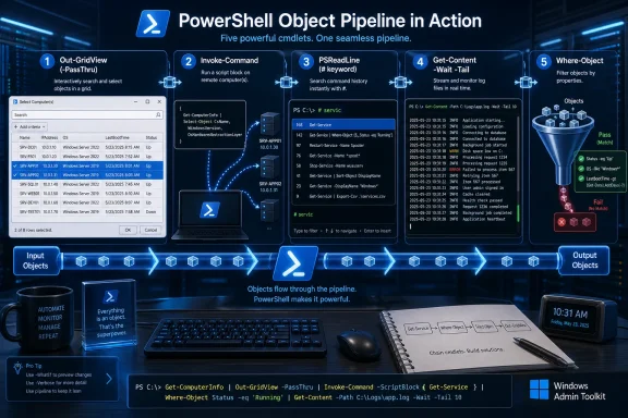

PowerShell pipeline diagram shows cmdlets flowing through servers with log output in a tech-themed UI.The Cheat Code Is Really the Pipeline​
PowerShell has always had a branding problem. To casual Windows users, it looks like a sterner Command Prompt. To Linux veterans, it can look verbose, ceremonial, and faintly Microsoftian in all the predictable ways. To administrators who use it daily, though, the shell is less a place to type commands than a way to move structured information from one decision point to another.
That is why the five commands highlighted by How-To Geek are a useful snapshot of PowerShell at its best. None of them is exotic. None requires a third-party module in the normal desktop-administration case. Their value comes from the same design choice Microsoft made years ago: PowerShell does not merely pass text around. It passes objects.
That difference matters. Text output invites grep-like reflexes, brittle parsing, and visual scanning. Objects preserve properties, types, and relationships, which means an administrator can search, filter, sort, select, export, or act on a result without reconstructing meaning from columns of text.
The “feels like cheating” part is not that Where-Object or Invoke-Command are secret weapons. It is that they collapse the gap between exploration and automation. The command you use to poke around interactively can become the same command you schedule, run against a fleet, or wire into a remediation script.

The list works because the commands compose. Invoke-Command can collect data from many machines. Where-Object can narrow the result. Out-GridView can let a human inspect or select the remaining objects. Get-Content -Wait can watch the log produced by the change. History search can retrieve the whole chain later.
That is the difference between a bag of tips and a working style. PowerShell rewards users who think in pipelines. It is less about memorizing 500 cmdlets than recognizing that each command should accept input, preserve structure, and emit something another command can use.
Consider the ordinary case of investigating a failing service across a small server group. An administrator can run a remote query, filter for stopped or unhealthy services, sort by computer name, and send the result to a grid. If a few rows matter, -PassThru can carry those selections into export, restart, or reporting steps. The commands remain small, but the workflow becomes substantial.
