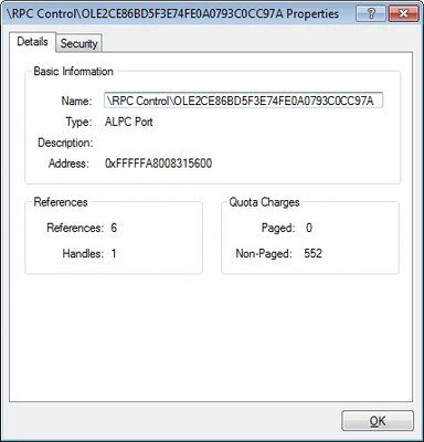

I've managed to pin point what exactly is causing the problem inside the dllhost.exe process with the help of Process Explorer (by Sysinternals) and its listing of Handles inside each process.
When the problem happened I went into the list of Handles inside dllhost.exe and started closing handles one by one to see after which one the problem disappears.
It turns out to be something called "ALPC Port/RPC Control" (Screenshot attached)
I really hope this info will help in figuring out this annoying problem.
