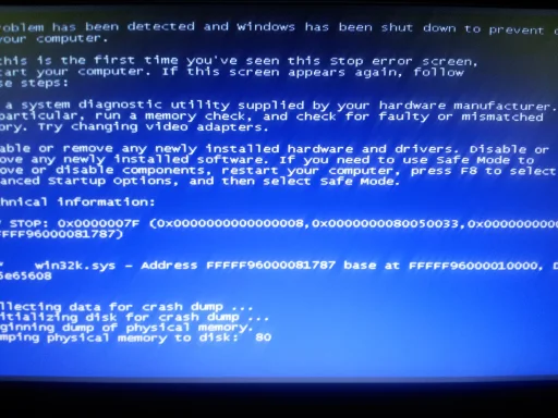

About a month ago iv noticed that in rare occasions this bsod would pop up out of the blue and i haven't found any way to fix it. It seems to happen most commonly in Gta 5 on steam while playing. Another problem i found is that no matter what i do no mini dumps appear in its usual plase, il also leave a picture of the bsod on my screen. Thank you

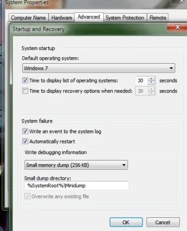

to help you best we need to see the actual dump files. As your machine isn't creating them please make sure your settings are set like thus:
Open the run application.
Type sysdm.cpl in the run box and click ok.
Look across the top of the system properties box for 'Advanced' and click that.
Look for 'Startup and Recovery' near the bottom and click 'settings'.
Near the bottom you'll see a drop down menu under the heading 'write debugging information'.
In the drop down menu choose ' small memory dump (256KB)'
Under 'small dump directory' make sure it says %SystemRoot%\Minidump.
Click ok and your good to go.

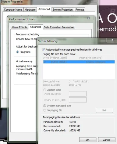

Other reasons for no dump file can include no pagefile or one that's below 200mb so if you changed it return to default values.

This bugcheck can mean hardware failure although if your overclocking please return to default values and see if the bsod stops. This bugcheck can often be attributed to failing RAM as well as an out of date Bios. Once I see the dump file i'll be able to tell you more.

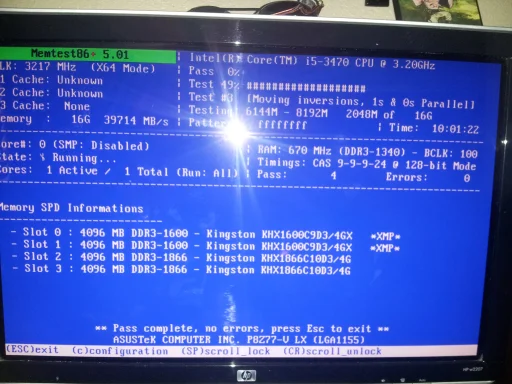

Windows does have a memory testing app but it can miss errors and the best app for the job is Memtest86.
If you open the link below you'll see you can run Memtest86 in two ways. You can either burn it to disk or install it onto a USB drive it's entirely up to you. You'll then need to enter the bios to change the boot order so you can boot from either the Disk or USB stick you have Memtest86 on.
You must test for at least 12 hours unless it becomes obvious there is a problem straight away (you'll see errors outlined in red.
Memtest86+ - Advanced Memory Diagnostic Tool
Ok i so i added that Memtest86 and did all the things you said with the dump files but the problem is those where already the settings that have been on. i show in screenshot. So right now i am attempting to trigger this bsod to get that dump. Thank you very much for your fast reply :)

Don't forget what i said about the pagefile. As soon as you post the dump file we can debug. Also you can always test your RAM in the meantime.
What does this mean?
You can't 'add it' to anything. You need to run the app using either a disk or usb stick. If your not sure how to use it then let us know and we'll help.
i added it to my usb so what do i do now?

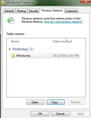

I also looked at the modified date of the dump and it still says last modified 3 months ago with nothing in it but when i looked in its property's it said it was last used yesterday at the time of the previews bsod. And i set all the pagefile stuff to its default.
To run memtest86 from either disk or usb you need to enter the bios and change the boot order. This is so when the machine boots up it will boot from the USB stick and not your HDD.

I booted the usb from the bios so do i just wait?
And the problem is that the bsods just not making dump files even tho it says it is in the bsod itself.

Ok thats good. I see you have two different speeds of RAM running together. Normally in this situation the RAM will default to the lower speed but i wonder if this causing an issue as 2 are running in XMP profiles and two are not. If the bsod continues I would, as a test, remove two of the sticks making sure what you leave behind is both the same.

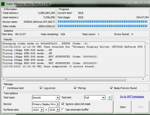

Lets check the Vram on the card:
HOME PAGE OF MISHA CHERKES
Update the above and see how you go. Post any new dump files.
