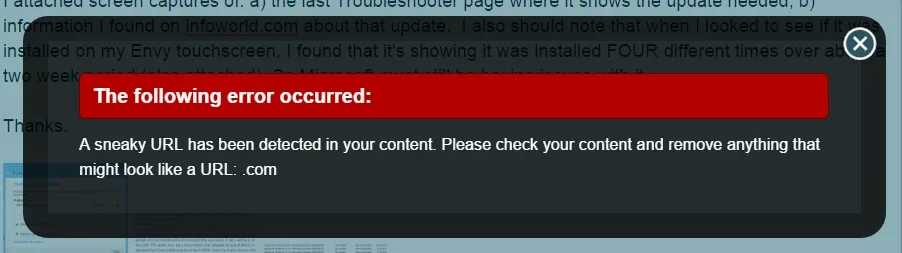

Sorry, ignore the Red & Black error message attachment. I forgot to remove it from the upload list. It was an error I kept getting when I'd hit the Post Reply button. I finally figure out I was getting that because I included the ".com" to infoworld.
