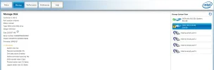

Also, I've just got the Intel RST Software running, and so far it is the only program which is able to show and recognise the SSD.
When I had a look, the program is saying that the drive is "password locked"? Now I've no idea where that came from, because I'm more than certain that I did not password lock it.
The EaseUS program isn't able to recognise the drive so far.
Any thoughts or suggestions?

I can't see anything on the picture you sent, it is too low resolution.
Did you enable AHCI Mode?
What the SSD Manager shows? It doesn't see also the ssd?
Please read all my posts and give me more details. Where did you buy the ssd?
Sent from my SM-N950F using Tapatalk

AHCI mode is enabled.
SSD Manager doesn't show anything, because it also doesn't see the SSD
Bought the SSD from eBuyer.

If it shows that it is password protected, it just means that it wasn't new and you should return it. I do not know how to unlock or even if it is possible to unlock a password protected ssd. But if it was brand new, than there is no reason to be password locked, unless you did lock it up. I'm sorry I can't be of further help.
